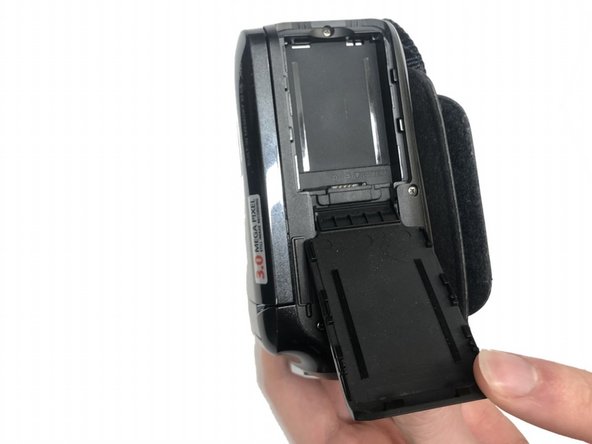

    • Orient your camcorder upside down, with the model number sticker facing towards you.
  2. Canon Vixia HF R21 Battery Replacement: crwdns2935265:02crwdnd2935265:01crwdnd2935265:02crwdne2935265:0 Canon Vixia HF R21 Battery Replacement: crwdns2935265:02crwdnd2935265:02crwdnd2935265:02crwdne2935265:0
    • Place your thumbs on the battery compartment.
    • Push down and forward on the square divot to open the battery compartment.
    • The compartment should now hang over the top of the camcorder.
  3. Canon Vixia HF R21 Battery Replacement: crwdns2935265:03crwdnd2935265:01crwdnd2935265:02crwdne2935265:0 Canon Vixia HF R21 Battery Replacement: crwdns2935265:03crwdnd2935265:02crwdnd2935265:02crwdne2935265:0
    • Lift the battery cover towards yourself to open it.
  4. Canon Vixia HF R21 Battery Replacement: crwdns2935265:04crwdnd2935265:01crwdnd2935265:01crwdne2935265:0
    • Pull the battery out by placing your finger at the indentation and pulling towards yourself.
