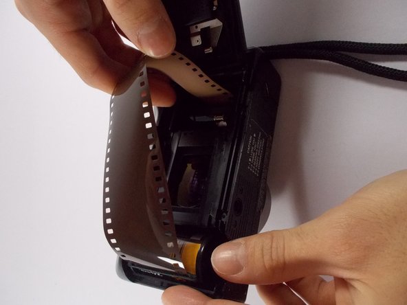

    • On the side of your camera, push the strip of black plastic located in between "open" and a down arrow, down to open the camera. The back of the camera will pop open showing the film.
  2. Canon Sure Shot Z115 Caption Film Replacement: crwdns2935265:02crwdnd2935265:01crwdnd2935265:02crwdne2935265:0 Canon Sure Shot Z115 Caption Film Replacement: crwdns2935265:02crwdnd2935265:02crwdnd2935265:02crwdne2935265:0
    • Locate the side of the film that holds all the film. Push it forward and lift it out of the camera.
  3. Canon Sure Shot Z115 Caption Film Replacement: crwdns2935265:03crwdnd2935265:01crwdnd2935265:01crwdne2935265:0
    • Pull the rest of the film out from the other side.

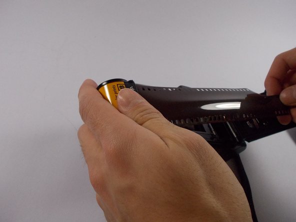

  4. Canon Sure Shot Z115 Caption Film Replacement: crwdns2935265:04crwdnd2935265:01crwdnd2935265:02crwdne2935265:0 Canon Sure Shot Z115 Caption Film Replacement: crwdns2935265:04crwdnd2935265:02crwdnd2935265:02crwdne2935265:0
    • Take you new roll of film and pull film out until it's the horizontal length of the camera.
  5. Canon Sure Shot Z115 Caption Film Replacement: crwdns2935265:05crwdnd2935265:01crwdnd2935265:01crwdne2935265:0
    • Place the roll part of the film in the corresponding side.

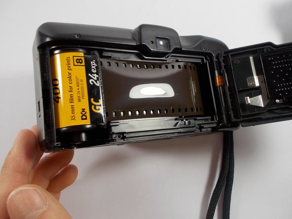

  6. Canon Sure Shot Z115 Caption Film Replacement: crwdns2935265:06crwdnd2935265:01crwdnd2935265:03crwdne2935265:0 Canon Sure Shot Z115 Caption Film Replacement: crwdns2935265:06crwdnd2935265:02crwdnd2935265:03crwdne2935265:0 Canon Sure Shot Z115 Caption Film Replacement: crwdns2935265:06crwdnd2935265:03crwdnd2935265:03crwdne2935265:0
    • Take the film and feed it through the right side of the plastic cylinder. The film should wrap around it.
Close the cover that covers the film that you opened in part 1.
