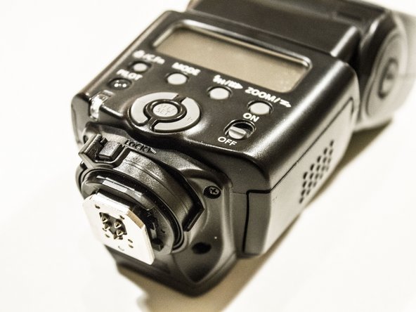

    • Remove batteries
    • Remove the 4 screws at the bottom of the flash
    • Remove mounting cap on the side of the flash
    • Carefully unplug the socket from the circuit board.

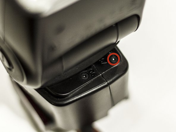

    • Turn the flash head 90º.
    • Remove both screws right below the 75 mark. These are the screws holding the smaller back casing in place.

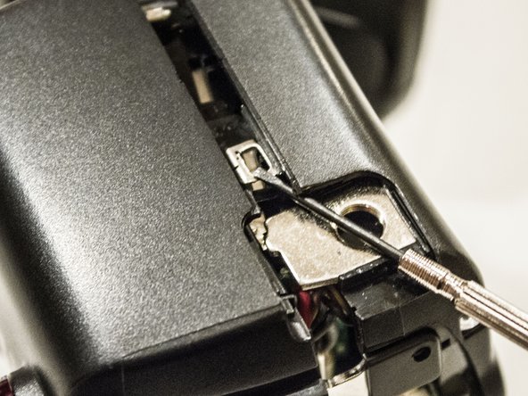

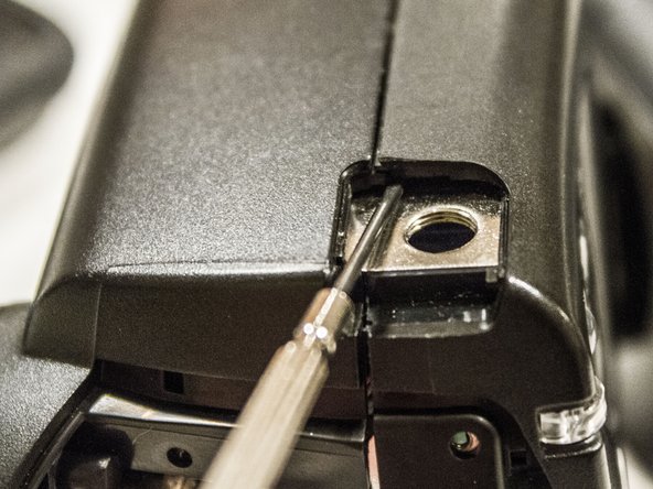

    • READ THIS!!!! This is not a "the bigger the hammer the smaller the problem" step. You mess this up and you will need to duck-tape your flash back together. Also...: make sure you don't snap a plastic tool.
    • Looking flat into the opening you should see a metal part far in.
    • With a flat driver try to get between the plastic casing and this metal part to pry it out of the locking notch.

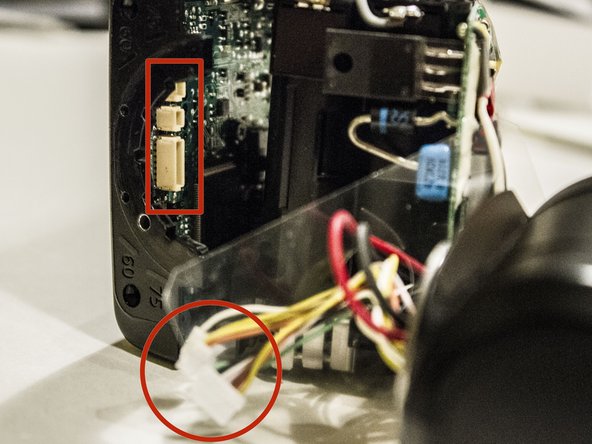

    • Image 3 illustrates the metal tab you need to press down for the side to open.
    • One more time: Make sure you are getting between the casing and the metal tab. Inserting and twisting a small screw driver worked for me after a few tries.

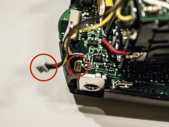

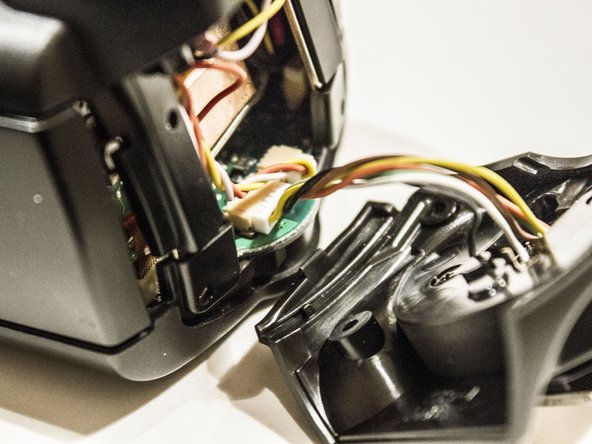

  5. Canon Speedlight 430EX II LCD Replacement, Unplug Wires: crwdns2935265:05crwdnd2935265:01crwdnd2935265:03crwdne2935265:0 Canon Speedlight 430EX II LCD Replacement, Unplug Wires: crwdns2935265:05crwdnd2935265:02crwdnd2935265:03crwdne2935265:0 Canon Speedlight 430EX II LCD Replacement, Unplug Wires: crwdns2935265:05crwdnd2935265:03crwdnd2935265:03crwdne2935265:0
    • Remove front casing with infrared sensor by removing one plug.
    • Detach 3 wires going from flash head to circuit board.
    • Remove brown and yellow wire from circuit board connecting the battery case.
  6. Canon Speedlight 430EX II LCD Replacement, Access LCD Circuit Board: crwdns2935265:06crwdnd2935265:01crwdnd2935265:03crwdne2935265:0 Canon Speedlight 430EX II LCD Replacement, Access LCD Circuit Board: crwdns2935265:06crwdnd2935265:02crwdnd2935265:03crwdne2935265:0 Canon Speedlight 430EX II LCD Replacement, Access LCD Circuit Board: crwdns2935265:06crwdnd2935265:03crwdnd2935265:03crwdne2935265:0
    • Gently pull flat band out of the circuit board mount. You might use the pliers but don't bend the band.
    • Move the 3 wires out from the gap between the casing and circuit board.
    • First: White
    • Second: Orange
    • Third: Black. This is the one we need to free.
    • Now the back casing with circuit board should come lose. Only attached by the black wire.
    • Also pull out the 2 metal mounting plates.

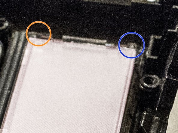

    • There are 2 tabs (red) the new LCD needs to slide under.
    • Now place the clear plastic plate on top of the new display. MAKE SURE it is in the correct orientation. In the image the BLUE notch is a bit larger than the orange one.
    • Press the edges of the plastic lightly and it will snap into the case.

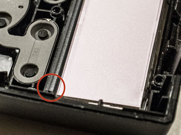

    • Remove the rubber band gently from the old LCD and place it into the groove (image 3, red). Make sure it is aligned correctly.
