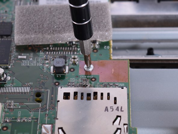

    1. Canon Selphy CP910 Printer Body Replacement, Printer Body: crwdns2935265:05crwdnd2935265:01crwdnd2935265:02crwdne2935265:0 Canon Selphy CP910 Printer Body Replacement, Printer Body: crwdns2935265:05crwdnd2935265:02crwdnd2935265:02crwdne2935265:0
      • Use the PH1 screw driver to remove the three screws on the motherboard.

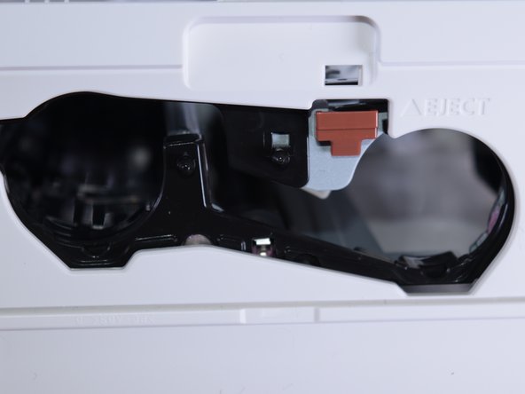

    2. Canon Selphy CP910 Printer Body Replacement: crwdns2935265:06crwdnd2935265:01crwdnd2935265:02crwdne2935265:0 Canon Selphy CP910 Printer Body Replacement: crwdns2935265:06crwdnd2935265:02crwdnd2935265:02crwdne2935265:0
      • Remove the printer.
      • This will prevent the printer from falling out during repair.

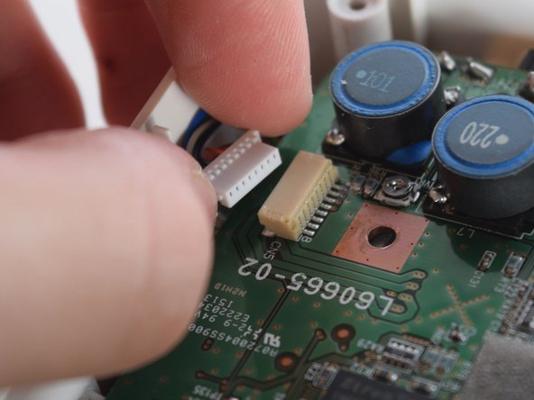

    3. Canon Selphy CP910 Printer Body Replacement: crwdns2935265:07crwdnd2935265:01crwdnd2935265:03crwdne2935265:0 Canon Selphy CP910 Printer Body Replacement: crwdns2935265:07crwdnd2935265:02crwdnd2935265:03crwdne2935265:0 Canon Selphy CP910 Printer Body Replacement: crwdns2935265:07crwdnd2935265:03crwdnd2935265:03crwdne2935265:0
      • Remove the output connections.
      • Be careful! Do not pull too hard because the wires might rip.
      • Output connections are located on the corners of the motherboard.

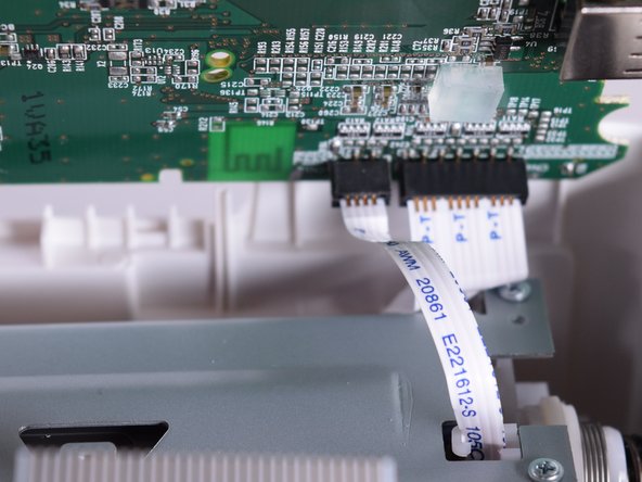

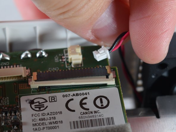

    4. Canon Selphy CP910 Printer Body Replacement: crwdns2935265:08crwdnd2935265:01crwdnd2935265:02crwdne2935265:0 Canon Selphy CP910 Printer Body Replacement: crwdns2935265:08crwdnd2935265:02crwdnd2935265:02crwdne2935265:0
      • The motherboard is attached to three more ribbon wires.
      • Detach these wires.
      • Be careful not to pull too hard.
    5. Canon Selphy CP910 Printer Body Replacement: crwdns2935265:09crwdnd2935265:01crwdnd2935265:02crwdne2935265:0 Canon Selphy CP910 Printer Body Replacement: crwdns2935265:09crwdnd2935265:02crwdnd2935265:02crwdne2935265:0

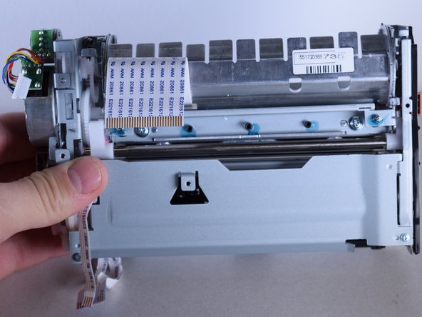

      • Separate the motherboard from the main hard drive.
    6. Canon Selphy CP910 Printer Body Replacement: crwdns2935265:010crwdnd2935265:01crwdnd2935265:03crwdne2935265:0 Canon Selphy CP910 Printer Body Replacement: crwdns2935265:010crwdnd2935265:02crwdnd2935265:03crwdne2935265:0 Canon Selphy CP910 Printer Body Replacement: crwdns2935265:010crwdnd2935265:03crwdnd2935265:03crwdne2935265:0
      • Remove the main hard drive from the printer body.

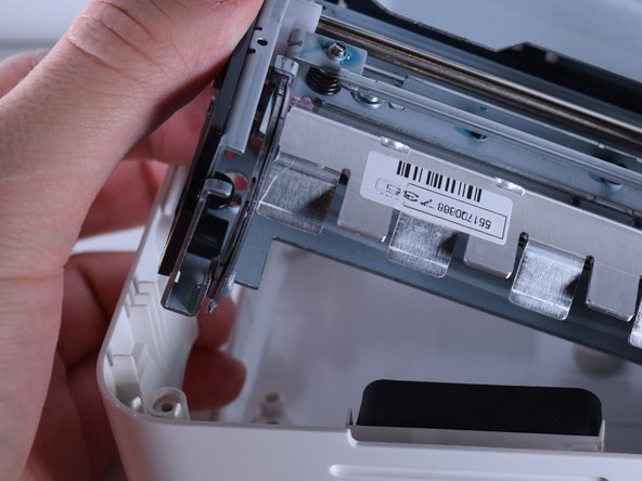

    7. Canon Selphy CP910 Printer Body Replacement: crwdns2935265:011crwdnd2935265:01crwdnd2935265:02crwdne2935265:0 Canon Selphy CP910 Printer Body Replacement: crwdns2935265:011crwdnd2935265:02crwdnd2935265:02crwdne2935265:0
      • Gently remove the fan from the body.
      • The fan is glued to the case. When you install it in the new body, use hot glue to secure it in place.

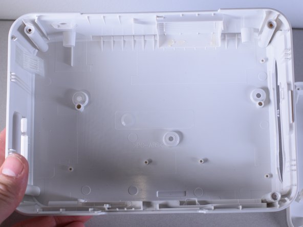

    8. Canon Selphy CP910 Printer Body Replacement: crwdns2935265:012crwdnd2935265:01crwdnd2935265:02crwdne2935265:0 Canon Selphy CP910 Printer Body Replacement: crwdns2935265:012crwdnd2935265:02crwdnd2935265:02crwdne2935265:0
      • The empty case will look like this once all the parts are removed.
