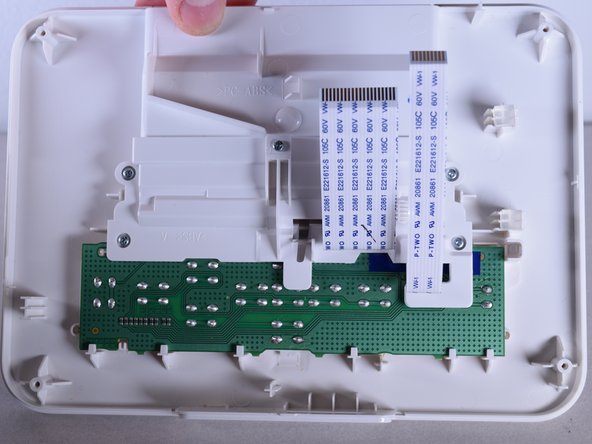

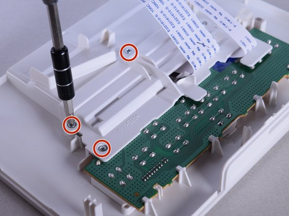

  5. Canon Selphy CP910 Buttons Replacement, Buttons: crwdns2935265:05crwdnd2935265:01crwdnd2935265:02crwdne2935265:0 Canon Selphy CP910 Buttons Replacement, Buttons: crwdns2935265:05crwdnd2935265:02crwdnd2935265:02crwdne2935265:0
    • Turn the top panel over so the inside faces toward you.

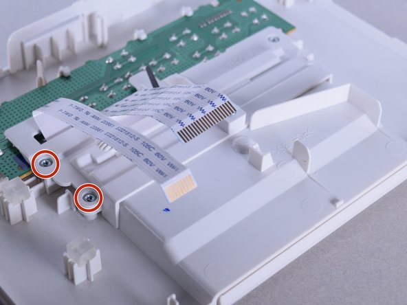

  6. Canon Selphy CP910 Buttons Replacement: crwdns2935265:06crwdnd2935265:01crwdnd2935265:03crwdne2935265:0 Canon Selphy CP910 Buttons Replacement: crwdns2935265:06crwdnd2935265:02crwdnd2935265:03crwdne2935265:0 Canon Selphy CP910 Buttons Replacement: crwdns2935265:06crwdnd2935265:03crwdnd2935265:03crwdne2935265:0
    • Use the PH0 screw bit to remove the five 10 mm screws located above the circuit board.

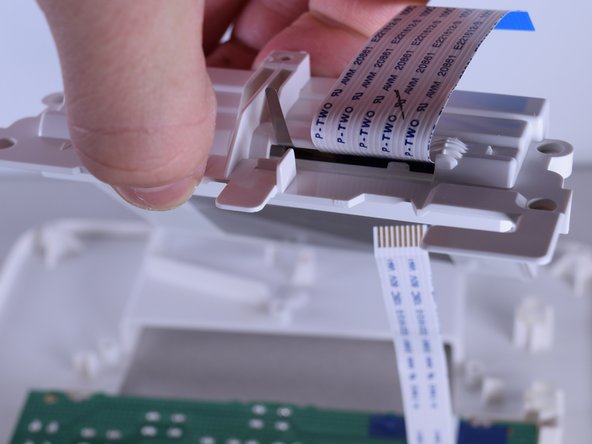

  7. Canon Selphy CP910 Buttons Replacement: crwdns2935265:07crwdnd2935265:01crwdnd2935265:02crwdne2935265:0 Canon Selphy CP910 Buttons Replacement: crwdns2935265:07crwdnd2935265:02crwdnd2935265:02crwdne2935265:0
    • Carefully remove the frame attached to the screen.

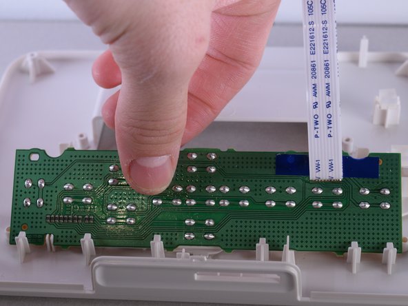

  8. Canon Selphy CP910 Buttons Replacement: crwdns2935265:08crwdnd2935265:01crwdnd2935265:03crwdne2935265:0 Canon Selphy CP910 Buttons Replacement: crwdns2935265:08crwdnd2935265:02crwdnd2935265:03crwdne2935265:0 Canon Selphy CP910 Buttons Replacement: crwdns2935265:08crwdnd2935265:03crwdnd2935265:03crwdne2935265:0
    • Take out the circuit board.
    • Once you take out the circuit board, you should be left with just the case.

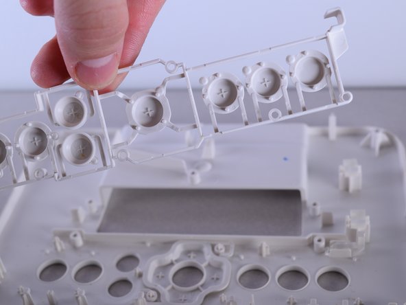

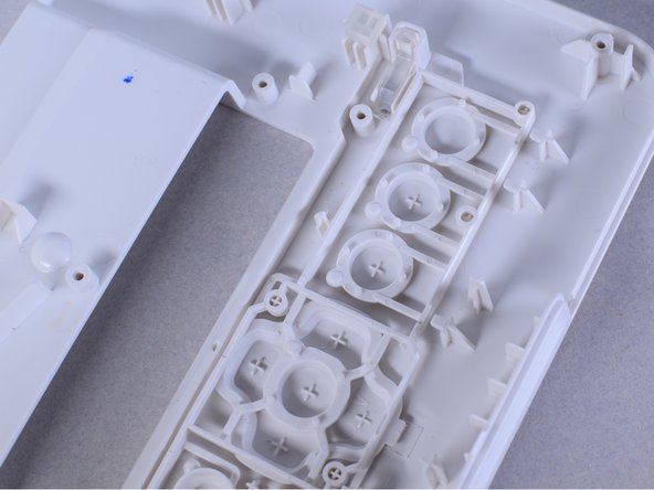

  9. Canon Selphy CP910 Buttons Replacement: crwdns2935265:09crwdnd2935265:01crwdnd2935265:02crwdne2935265:0 Canon Selphy CP910 Buttons Replacement: crwdns2935265:09crwdnd2935265:02crwdnd2935265:02crwdne2935265:0
    • There is a clear plastic “L” shaped piece that acts as the power light for the printer. The piece is not attached to the printer so take care not to lose it.
    • Remove the button framework and replace it with new one.
