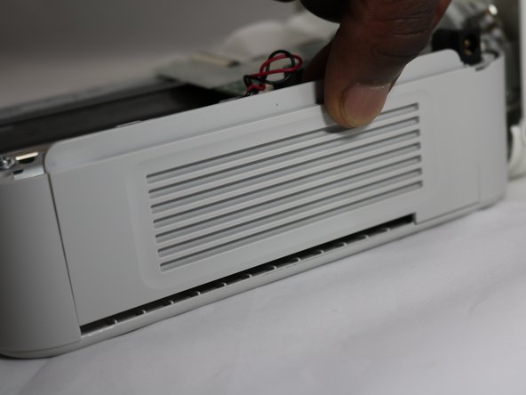

  3. Canon Selphy CP720 Cooling Fan Replacement: crwdns2935265:03crwdnd2935265:01crwdnd2935265:03crwdne2935265:0 Canon Selphy CP720 Cooling Fan Replacement: crwdns2935265:03crwdnd2935265:02crwdnd2935265:03crwdne2935265:0 Canon Selphy CP720 Cooling Fan Replacement: crwdns2935265:03crwdnd2935265:03crwdnd2935265:03crwdne2935265:0
    • Remove the side panel by lifting it out.

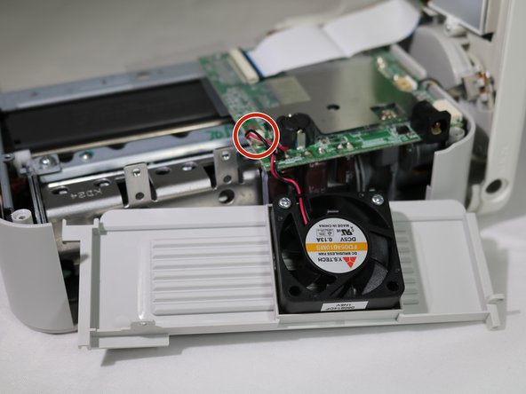

  4. Canon Selphy CP720 Cooling Fan Replacement: crwdns2935265:04crwdnd2935265:01crwdnd2935265:02crwdne2935265:0 Canon Selphy CP720 Cooling Fan Replacement: crwdns2935265:04crwdnd2935265:02crwdnd2935265:02crwdne2935265:0
    • Unplug the fan from the circuit board by gently pulling on the wire connector at the base of the port.
    • Do not tug on the wires. Slowly increasing force as you pull is the best way to detach the wires.

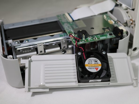

  5. Canon Selphy CP720 Cooling Fan Replacement: crwdns2935265:05crwdnd2935265:01crwdnd2935265:01crwdne2935265:0
    • Unscrew the two 8mm Phillips #1 screws from the fan.
    • Remove the fan from the panel.
