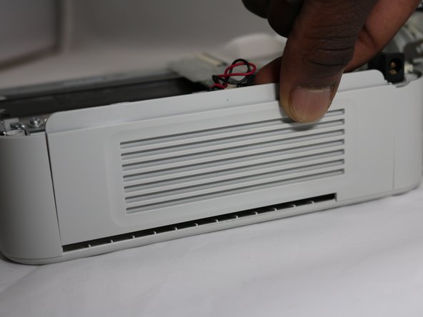

    • Remove the four 8mm Phillips #1 screws, located in each corner of the device.
  3. Canon Selphy CP720 Circuit Boards Replacement: crwdns2935265:03crwdnd2935265:01crwdnd2935265:01crwdne2935265:0
    • Grasp one half of the device's shell in each hand, and pull them apart. They are connected, so don't separate them completely.
  4. Canon Selphy CP720 Circuit Boards Replacement: crwdns2935265:04crwdnd2935265:01crwdnd2935265:02crwdne2935265:0 Canon Selphy CP720 Circuit Boards Replacement: crwdns2935265:04crwdnd2935265:02crwdnd2935265:02crwdne2935265:0
    • Lift the side panel off to expose the inside of the printer.
