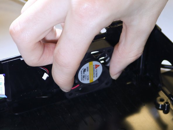

  13. Canon Selphy CP1200 Cooling Fan Replacement, Cooling Fan: crwdns2935265:013crwdnd2935265:01crwdnd2935265:01crwdne2935265:0
    • Lift out the back case plate.
  14. Canon Selphy CP1200 Cooling Fan Replacement: crwdns2935265:014crwdnd2935265:01crwdnd2935265:02crwdne2935265:0 Canon Selphy CP1200 Cooling Fan Replacement: crwdns2935265:014crwdnd2935265:02crwdnd2935265:02crwdne2935265:0
    • Remove the fan by tilting it forward slightly and then lifting upwards.
