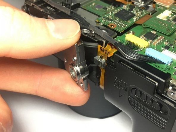

  11. Canon Powershot SX10 IS Tripod Screw Mount Replacement, Tripod Screw Mount: crwdns2935265:011crwdnd2935265:01crwdnd2935265:02crwdne2935265:0 Canon Powershot SX10 IS Tripod Screw Mount Replacement, Tripod Screw Mount: crwdns2935265:011crwdnd2935265:02crwdnd2935265:02crwdne2935265:0
    • Remove one screw that holds both a black cable and part of the tripod mount.
    • The silver bracket and black cable will pop right off.
  12. Canon Powershot SX10 IS Tripod Screw Mount Replacement: crwdns2935265:012crwdnd2935265:01crwdnd2935265:02crwdne2935265:0 Canon Powershot SX10 IS Tripod Screw Mount Replacement: crwdns2935265:012crwdnd2935265:02crwdnd2935265:02crwdne2935265:0
    • Remove the four screws remaining that hold the tripod screw mount into the body of the camera.
    • Using your fingers, remove the tripod screw mount from the body of the camera.
