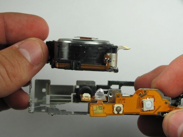

  19. Canon Powershot SD750 Camera Lens Replacement, Camera Lens: crwdns2935265:019crwdnd2935265:01crwdnd2935265:02crwdne2935265:0 Canon Powershot SD750 Camera Lens Replacement, Camera Lens: crwdns2935265:019crwdnd2935265:02crwdnd2935265:02crwdne2935265:0
    • Place the camera facing forward so that the LCD screen side is facing up.
    • Remove the four 3.2 mm Phillips screws with a #00 Phillips screwdriver.
    • Note: The screws are located around the edges connecting the lens to the casing.
    • Do not remove the top right Phillips screw because the lens gears may fall out.
  20. Canon Powershot SD750 Camera Lens Replacement: crwdns2935265:020crwdnd2935265:01crwdnd2935265:02crwdne2935265:0 Canon Powershot SD750 Camera Lens Replacement: crwdns2935265:020crwdnd2935265:02crwdnd2935265:02crwdne2935265:0
    • Place the camera facing backward so that the lens is facing up.
    • Then pull the lens out from the front of the casing using your fingers.
