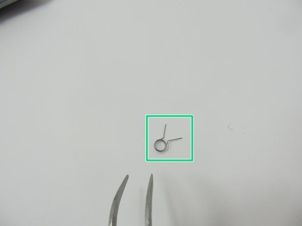

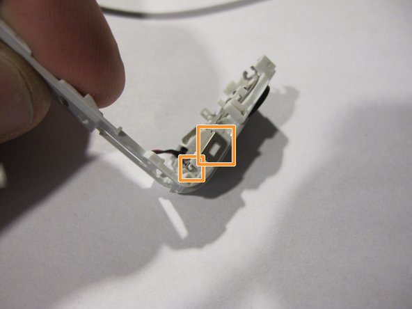

    • Remove the 3.1mm screw holding speaker to the housing.
    • Remove the two clips and the metal cover will be released
    • When you remove the metal cover the spring will shoot out.
    • Take note of the spring and its orientation, it will need to be re-installed later
    • Image of the spring
  16. Canon Powershot ELPH 100 HS Speaker Replacement: crwdns2935265:016crwdnd2935265:01crwdnd2935265:02crwdne2935265:0 Canon Powershot ELPH 100 HS Speaker Replacement: crwdns2935265:016crwdnd2935265:02crwdnd2935265:02crwdne2935265:0
    • Using tweezers, grab the wires to pull the speaker from the plastic housing.
    • Use force as the speaker is glued to the housing.
