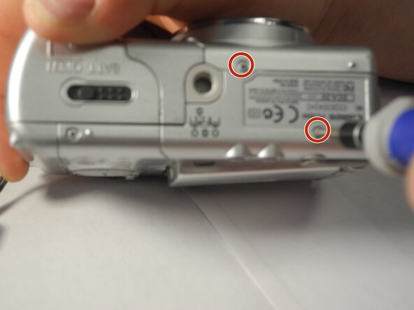

    • There are two screws to the right of the battery slot.
    • Take the #00 Phillips-head screwdriver and remove the two screws.

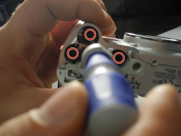

    • Inside the battery slot, there are another 3 screws located at the very bottom of each slot.
    • To reach these screws and remove them, attach the screwdriver extender to the #00 Phillips-head screwdriver.

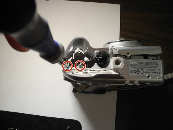

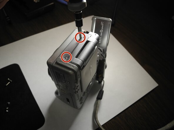

    • At the base of the battery flap, there are 2 screws located next to the hinges of the opening.
    • Remove both screws.

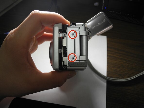

    • Once the top is loose, locate the 2 screws near the AV outlet.
    • The removal of the 2 screws will allow you to remove the plastic AV covering.
    • Once the AV cover is removed, there will be 1 more screw left to remove.

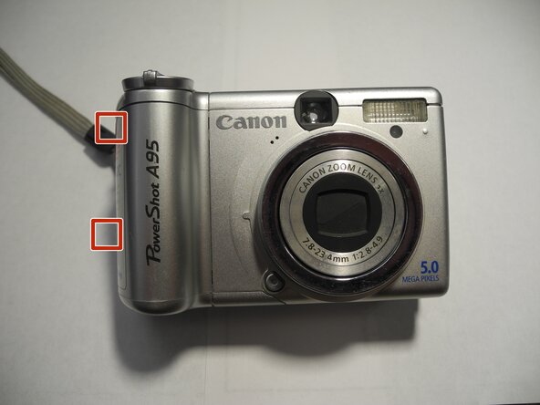

    • Using the pry tool, gently remove the front cover of the camera in order to expose the flash and the lens.
