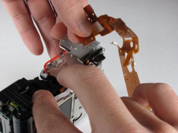

    • Gently pull the rest of the flex assembly away from the camera body until you reach the last connector.
  22. Canon Powershot A70 LCD Screen Replacement: crwdns2935265:022crwdnd2935265:01crwdnd2935265:02crwdne2935265:0 Canon Powershot A70 LCD Screen Replacement: crwdns2935265:022crwdnd2935265:02crwdnd2935265:02crwdne2935265:0
    • Hold the flex assembly gently but firmly, and pull it out of the connection with two fingers.
    • Be sure to pull straight up, not at an angle.
