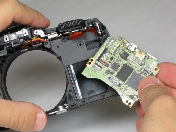

  12. Canon PowerShot SX520 HS Motherboard Replacement, Motherboard: crwdns2935265:012crwdnd2935265:01crwdnd2935265:01crwdne2935265:0
    • Remove 1-2.5 mm screw using a Phillips #000 screwdriver.
  13. Canon PowerShot SX520 HS Motherboard Replacement: crwdns2935265:013crwdnd2935265:01crwdnd2935265:02crwdne2935265:0 Canon PowerShot SX520 HS Motherboard Replacement: crwdns2935265:013crwdnd2935265:02crwdnd2935265:02crwdne2935265:0
    • Disconnect the two orange serial cables at the top of the motherboard using your fingers.
    • Gently remove the motherboard using your fingers.
    • Too much force will break the motherboard.
