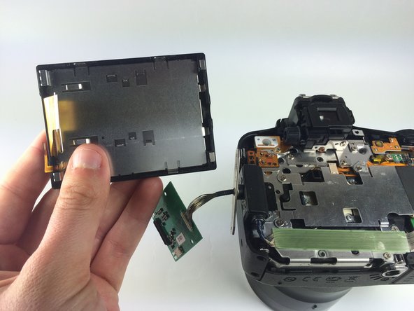

  9. Canon PowerShot SX50 HS LCD Screen Replacement: crwdns2935265:09crwdnd2935265:01crwdnd2935265:01crwdne2935265:0
    • Now you can completely separate the back encasement from the rest of the camera.

  14. Canon PowerShot SX50 HS LCD Screen Replacement: crwdns2935265:014crwdnd2935265:01crwdnd2935265:03crwdne2935265:0 Canon PowerShot SX50 HS LCD Screen Replacement: crwdns2935265:014crwdnd2935265:02crwdnd2935265:03crwdne2935265:0 Canon PowerShot SX50 HS LCD Screen Replacement: crwdns2935265:014crwdnd2935265:03crwdnd2935265:03crwdne2935265:0
    • To detach the larger wire ribbon, lift the release latch on the connector of the circuit board. Remove the wire ribbon with tweezers.
    • Now remove the smaller wire ribbon by pulling on it firmly but gently.
    • The wire ribbons are very delicate; be very cautious when detaching them!
    the smaller ribbon can be removed/repositioned easily. There is a small hole that can be used to pull/push the ribbon

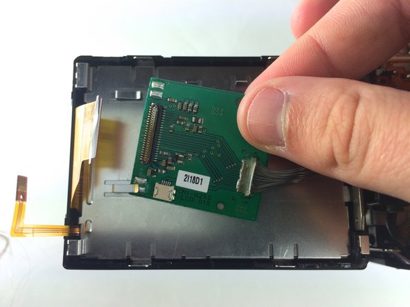

    • Use the curved tip tweezers to carefully remove the green circuit board out from under the two clips holding it in place. Then you can remove it completely with your fingers.
    • Now you can separate the LCD screen panel from the rest of the camera.
    in the circuitboard are two tiny holes through which two pins keep it in position. You have to lift/tilt the board to remove it. Be carefull when reposition the board.
    Mathieu Rutten - crwdns2934203:0crwdne2934203:0
