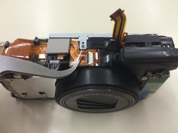

  7. Canon PowerShot SX260 HS Flash Assembly Replacement: crwdns2935265:07crwdnd2935265:01crwdnd2935265:02crwdne2935265:0 Canon PowerShot SX260 HS Flash Assembly Replacement: crwdns2935265:07crwdnd2935265:02crwdnd2935265:02crwdne2935265:0
    • Remove 1 (3 mm) screw from the flash generator with a Phillips screw driver
    • Gently lift the flash generator off of the camera with the plastic opening tool .
  8. Canon PowerShot SX260 HS Flash Assembly Replacement: crwdns2935265:08crwdnd2935265:01crwdnd2935265:01crwdne2935265:0
    • Gently unplug the ribbon cable with your tweezers.
    • Be careful not to rip it.
  9. Canon PowerShot SX260 HS Flash Assembly Replacement: crwdns2935265:09crwdnd2935265:01crwdnd2935265:02crwdne2935265:0 Canon PowerShot SX260 HS Flash Assembly Replacement: crwdns2935265:09crwdnd2935265:02crwdnd2935265:02crwdne2935265:0
    • Using your plastic opening tool to gently move the plug lock from the end of the ribbon cord by lifting it upward.
    • Gently remove the ribbon cable from the connector with tweezers.
  10. Canon PowerShot SX260 HS Flash Assembly Replacement: crwdns2935265:010crwdnd2935265:01crwdnd2935265:02crwdne2935265:0 Canon PowerShot SX260 HS Flash Assembly Replacement: crwdns2935265:010crwdnd2935265:02crwdnd2935265:02crwdne2935265:0
    • Gently remove the ribbon cable assembly from the top of the camera with your tweezers.
    • This cable is a long piece that runs across the top of the camera.
    • The flash assembly is connected to this cable.
    • Once removed gently lift out of the camera
    • Replace the ribbon cable with the attached flash assembly.
