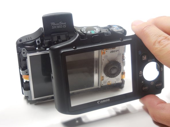

    3. Canon PowerShot SX160 IS Format Wheel Replacement: crwdns2935265:03crwdnd2935265:01crwdnd2935265:02crwdne2935265:0 Canon PowerShot SX160 IS Format Wheel Replacement: crwdns2935265:03crwdnd2935265:02crwdnd2935265:02crwdne2935265:0
      • Use your hands to gently separate the back plate from the camera.
      • Slowly pull off the camera plate until it fully detaches from the camera.
