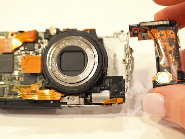

  23. Canon PowerShot SD960 IS Camera Lens Replacement: crwdns2935265:023crwdnd2935265:01crwdnd2935265:02crwdne2935265:0 Canon PowerShot SD960 IS Camera Lens Replacement: crwdns2935265:023crwdnd2935265:02crwdnd2935265:02crwdne2935265:0
    • To remove the flash assembly located on the right side of the camera, remove the 1.8mm screw from the right side of the bracket that is holding the flash assembly in place.
    • Swivel the bracket away from the body of the camera, and remove the remaining 1.8mm screw underneath.
  24. Canon PowerShot SD960 IS Camera Lens Replacement: crwdns2935265:024crwdnd2935265:01crwdnd2935265:01crwdne2935265:0
    • From the top of the camera, detach the flash assembly ribbon behind the flash bulb using the point of the spudger or small tweezers.
  25. Canon PowerShot SD960 IS Camera Lens Replacement: crwdns2935265:025crwdnd2935265:01crwdnd2935265:03crwdne2935265:0 Canon PowerShot SD960 IS Camera Lens Replacement: crwdns2935265:025crwdnd2935265:02crwdnd2935265:03crwdne2935265:0 Canon PowerShot SD960 IS Camera Lens Replacement: crwdns2935265:025crwdnd2935265:03crwdnd2935265:03crwdne2935265:0
    • Using your fingers, remove the flash assembly.
    • If difficult to remove, use the flat end of the spudger to lift the flash assembly from the bottom.
    • The flash assembly should now be free from the camera.
