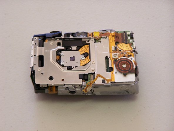

    • Slide the back casing (with the screen protector) off to reveal the LCD and back wiring.
  9. Canon PowerShot SD850 IS LCD Screen Replacement, LCD Screen: crwdns2935265:09crwdnd2935265:01crwdnd2935265:02crwdne2935265:0 Canon PowerShot SD850 IS LCD Screen Replacement, LCD Screen: crwdns2935265:09crwdnd2935265:02crwdnd2935265:02crwdne2935265:0

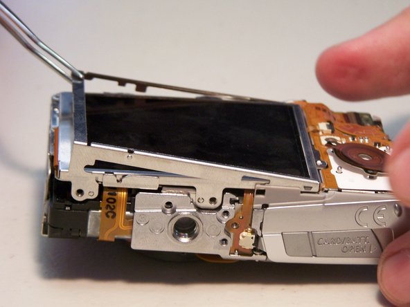

    • Remove the three screws attached to the bottom of the LCD brackets
  10. Canon PowerShot SD850 IS LCD Screen Replacement: crwdns2935265:010crwdnd2935265:01crwdnd2935265:02crwdne2935265:0 Canon PowerShot SD850 IS LCD Screen Replacement: crwdns2935265:010crwdnd2935265:02crwdnd2935265:02crwdne2935265:0
    • Remove the one quarter bracket around the LCD screen
    • Remove the three quarter bracket around the LCD screen.

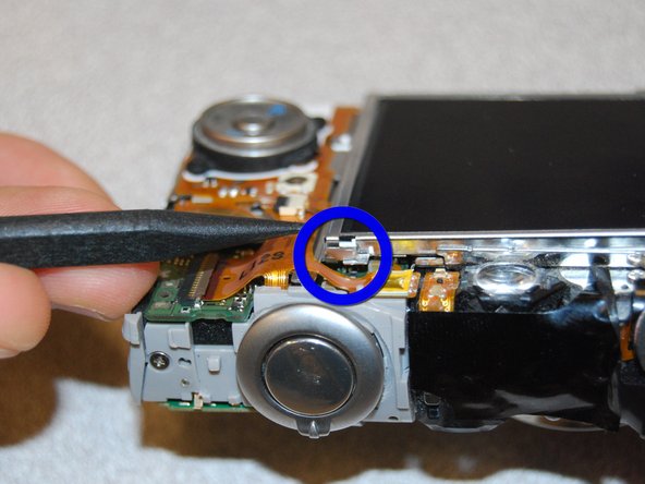

  11. Canon PowerShot SD850 IS LCD Screen Replacement: crwdns2935265:011crwdnd2935265:01crwdnd2935265:03crwdne2935265:0 Canon PowerShot SD850 IS LCD Screen Replacement: crwdns2935265:011crwdnd2935265:02crwdnd2935265:03crwdne2935265:0 Canon PowerShot SD850 IS LCD Screen Replacement: crwdns2935265:011crwdnd2935265:03crwdnd2935265:03crwdne2935265:0
    • Please Note: There are two areas of interest before removing the final bracket.
    • First, use a spudger to pry the the two tabs from the small guide pins.
    • Second, slide the bracket to the right as indicated in the second picture while lifting up. A small tab is holding the final bracket in place.
    • Remove the square metal bracket.

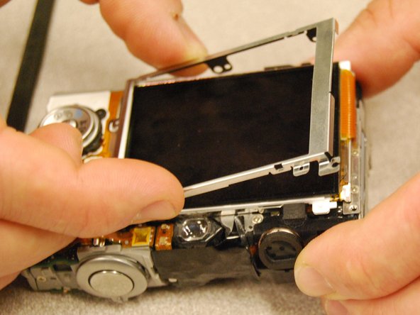

  12. Canon PowerShot SD850 IS LCD Screen Replacement: crwdns2935265:012crwdnd2935265:01crwdnd2935265:01crwdne2935265:0
    • At this point the screen should be easy to lift from the camera body.

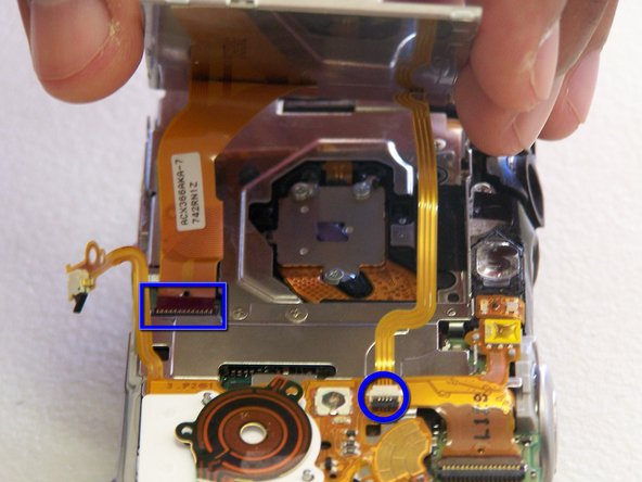

  13. Canon PowerShot SD850 IS LCD Screen Replacement: crwdns2935265:013crwdnd2935265:01crwdnd2935265:03crwdne2935265:0 Canon PowerShot SD850 IS LCD Screen Replacement: crwdns2935265:013crwdnd2935265:02crwdnd2935265:03crwdne2935265:0 Canon PowerShot SD850 IS LCD Screen Replacement: crwdns2935265:013crwdnd2935265:03crwdnd2935265:03crwdne2935265:0
    • Lift the LCD screen and remove the two ribbon cables.
