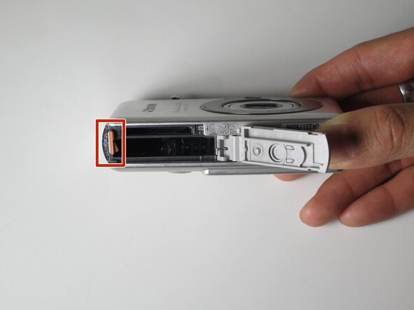

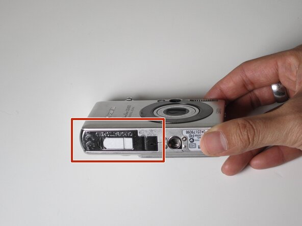

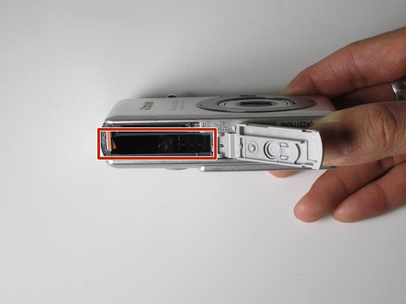

    • Slide the battery cover open (indicated by the blue box).
  2. Canon PowerShot SD400 LCD Replacement: crwdns2935265:02crwdnd2935265:01crwdnd2935265:01crwdne2935265:0
    • Push in the orange clip (indicated by the blue box) to eject the battery.
  3. Canon PowerShot SD400 LCD Replacement: crwdns2935265:03crwdnd2935265:01crwdnd2935265:01crwdne2935265:0
    • Insert the charged battery back into the slot (indicated by the blue box).
    • Close the cover.

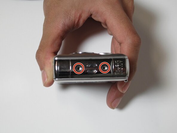

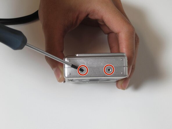

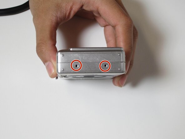

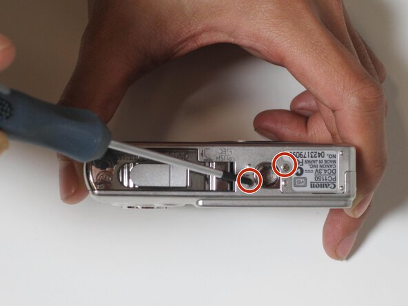

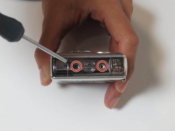

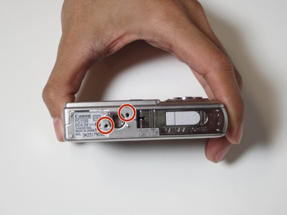

  4. Canon PowerShot SD400 LCD Replacement, LCD: crwdns2935265:04crwdnd2935265:01crwdnd2935265:03crwdne2935265:0 Canon PowerShot SD400 LCD Replacement, LCD: crwdns2935265:04crwdnd2935265:02crwdnd2935265:03crwdne2935265:0 Canon PowerShot SD400 LCD Replacement, LCD: crwdns2935265:04crwdnd2935265:03crwdnd2935265:03crwdne2935265:0
    • Locate these six screws that need to be removed to open the camera’s housing. These screws can be found on the bottom and both sides of the camera.
  5. Canon PowerShot SD400 LCD Replacement: crwdns2935265:05crwdnd2935265:01crwdnd2935265:03crwdne2935265:0 Canon PowerShot SD400 LCD Replacement: crwdns2935265:05crwdnd2935265:02crwdnd2935265:03crwdne2935265:0 Canon PowerShot SD400 LCD Replacement: crwdns2935265:05crwdnd2935265:03crwdnd2935265:03crwdne2935265:0
    • Using the screwdriver, carefully remove the exterior screws and place them in a safe location to avoid misplacing them.

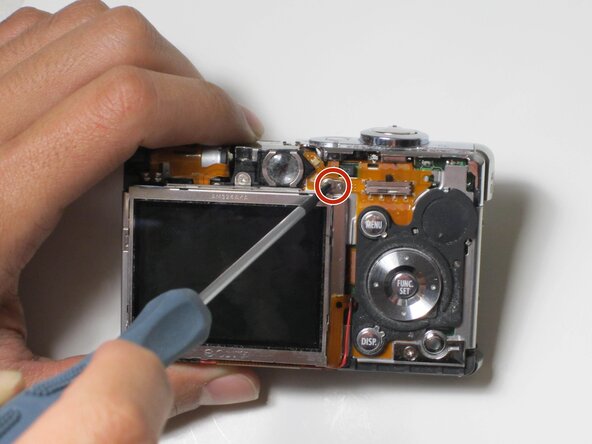

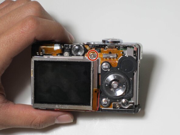

  6. Canon PowerShot SD400 LCD Replacement: crwdns2935265:06crwdnd2935265:01crwdnd2935265:02crwdne2935265:0 Canon PowerShot SD400 LCD Replacement: crwdns2935265:06crwdnd2935265:02crwdnd2935265:02crwdne2935265:0
    • Locate the interior screw that is above the top right of the LCD screen.
    • Remove the screw using the screwdriver.

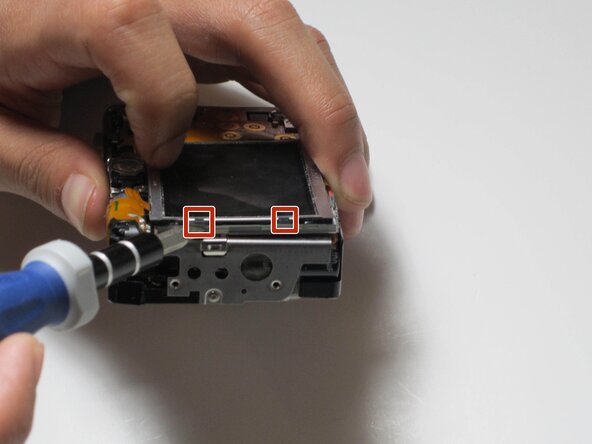

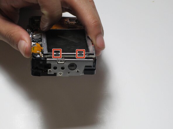

  7. Canon PowerShot SD400 LCD Replacement: crwdns2935265:07crwdnd2935265:01crwdnd2935265:03crwdne2935265:0 Canon PowerShot SD400 LCD Replacement: crwdns2935265:07crwdnd2935265:02crwdnd2935265:03crwdne2935265:0 Canon PowerShot SD400 LCD Replacement: crwdns2935265:07crwdnd2935265:03crwdnd2935265:03crwdne2935265:0
    • Locate the two clips on the left side of the LCD screen.
    • Carefully insert the tip of a flat-head screwdriver under the two clips of the LCD screen.
    • Slowly lift the screen using the flat-head screwdriver.
    • Potential for device damage Lift the screen gently to avoid any damage.
