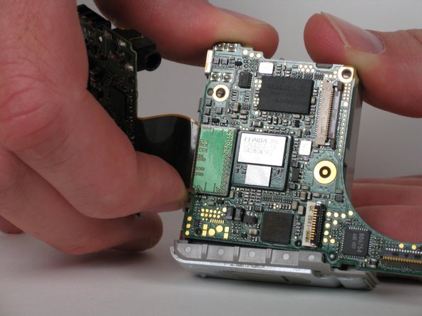

  25. Canon PowerShot SD200 Motherboard Replacement, Motherboard: crwdns2935265:025crwdnd2935265:01crwdnd2935265:02crwdne2935265:0 Canon PowerShot SD200 Motherboard Replacement, Motherboard: crwdns2935265:025crwdnd2935265:02crwdnd2935265:02crwdne2935265:0
    • Locate the black ZIF connector located directly below the lens.
    • Use the flat end of the spudger to flip up the black tab on the ZIF connector and pull the ribbon cable straight out.
  26. Canon PowerShot SD200 Motherboard Replacement: crwdns2935265:026crwdnd2935265:01crwdnd2935265:03crwdne2935265:0 Canon PowerShot SD200 Motherboard Replacement: crwdns2935265:026crwdnd2935265:02crwdnd2935265:03crwdne2935265:0 Canon PowerShot SD200 Motherboard Replacement: crwdns2935265:026crwdnd2935265:03crwdnd2935265:03crwdne2935265:0
    • Locate the brown ZIF connector located on the front of the camera.
    • Use the flat end of the spudger to push the small top brown tab out towards the lens. Repeat for the bottom brown tab.
    • Pull the ribbon cable out from the ZIF connector.

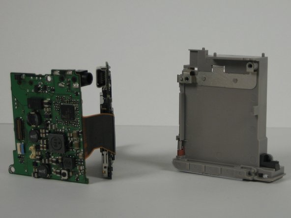

  27. Canon PowerShot SD200 Motherboard Replacement: crwdns2935265:027crwdnd2935265:01crwdnd2935265:01crwdne2935265:0
    • Pull the lens assembly away from the motherboard assembly.
  28. Canon PowerShot SD200 Motherboard Replacement: crwdns2935265:028crwdnd2935265:01crwdnd2935265:01crwdne2935265:0
    • Use the flat end of the spudger to loosen the connection from the battery holder and gently pry the side of the motherboard off of the battery holder.
  29. Canon PowerShot SD200 Motherboard Replacement: crwdns2935265:029crwdnd2935265:01crwdnd2935265:03crwdne2935265:0 Canon PowerShot SD200 Motherboard Replacement: crwdns2935265:029crwdnd2935265:02crwdnd2935265:03crwdne2935265:0 Canon PowerShot SD200 Motherboard Replacement: crwdns2935265:029crwdnd2935265:03crwdnd2935265:03crwdne2935265:0
    • Pull the back side of the motherboard around the battery holder.
    • Wiggle the motherboard so it can free itself completely from the battery holder.
