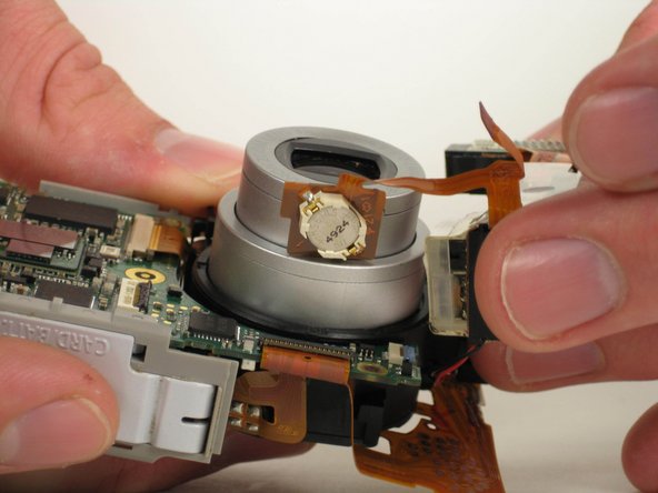

  23. Canon PowerShot SD200 Lens Assembly Replacement: crwdns2935265:023crwdnd2935265:01crwdnd2935265:02crwdne2935265:0 Canon PowerShot SD200 Lens Assembly Replacement: crwdns2935265:023crwdnd2935265:02crwdnd2935265:02crwdne2935265:0
    • Before working on the flash assembly make sure the flash is completely discharged or pay attention to where your fingers are. The capacitor in the flash assembly can hold a charge for a long time and it can shock you.
    • Lift flash assembly up.
    • Rotate flash assembly away from the camera.

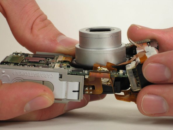

  24. Canon PowerShot SD200 Lens Assembly Replacement: crwdns2935265:024crwdnd2935265:01crwdnd2935265:03crwdne2935265:0 Canon PowerShot SD200 Lens Assembly Replacement: crwdns2935265:024crwdnd2935265:02crwdnd2935265:03crwdne2935265:0 Canon PowerShot SD200 Lens Assembly Replacement: crwdns2935265:024crwdnd2935265:03crwdnd2935265:03crwdne2935265:0
    • Use your fingers to give a small gap of space between the bottom of the lens assembly and the motherboard.
    • Slide the small circular battery, which is part of the flash assembly, through the small gap.
    • Separate the flash assembly from the rest of the camera.

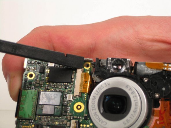

  25. Canon PowerShot SD200 Lens Assembly Replacement, Lens Assembly: crwdns2935265:025crwdnd2935265:01crwdnd2935265:02crwdne2935265:0 Canon PowerShot SD200 Lens Assembly Replacement, Lens Assembly: crwdns2935265:025crwdnd2935265:02crwdnd2935265:02crwdne2935265:0
    • Locate the black ZIF connector located directly below the lens.
    • Use the flat end of the spudger to flip up the black tab on the ZIF connector and pull the ribbon cable straight out.

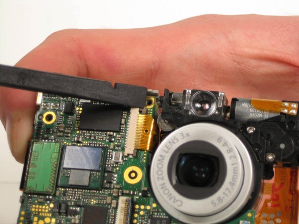

  26. Canon PowerShot SD200 Lens Assembly Replacement: crwdns2935265:026crwdnd2935265:01crwdnd2935265:03crwdne2935265:0 Canon PowerShot SD200 Lens Assembly Replacement: crwdns2935265:026crwdnd2935265:02crwdnd2935265:03crwdne2935265:0 Canon PowerShot SD200 Lens Assembly Replacement: crwdns2935265:026crwdnd2935265:03crwdnd2935265:03crwdne2935265:0
    • Locate the brown ZIF connector located on the front of the camera.
    • Use the flat end of the spudger to push the small top brown tab out towards the lens. Repeat for the bottom brown tab.
    • Pull the ribbon cable out from the ZIF connector.
