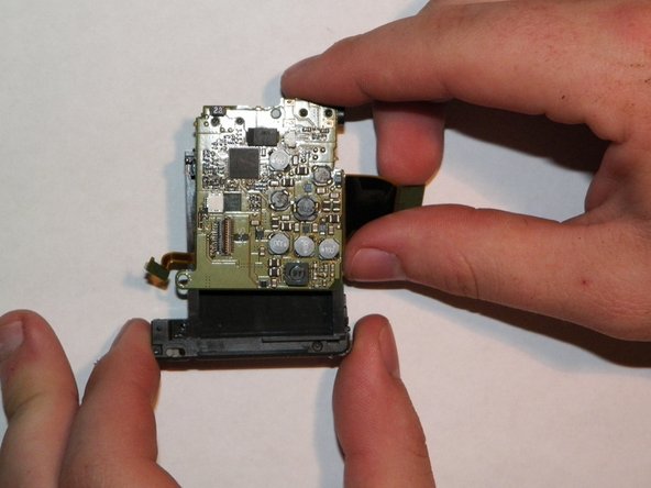

  26. Canon PowerShot SD 600 Rear Accessory Board and Battery Compartment Replacement, Motherboard: crwdns2935265:026crwdnd2935265:01crwdnd2935265:02crwdne2935265:0 Canon PowerShot SD 600 Rear Accessory Board and Battery Compartment Replacement, Motherboard: crwdns2935265:026crwdnd2935265:02crwdnd2935265:02crwdne2935265:0
    • Unsnap the connector that runs from the rear accessory board to the front of the camera.
    • The motherboard can be removed at roughly the same time as the lens assembly and the flash assembly. The cables that run to each of these components should also be disconnected if they have not been.

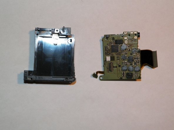

  27. Canon PowerShot SD 600 Rear Accessory Board and Battery Compartment Replacement: crwdns2935265:027crwdnd2935265:01crwdnd2935265:02crwdne2935265:0 Canon PowerShot SD 600 Rear Accessory Board and Battery Compartment Replacement: crwdns2935265:027crwdnd2935265:02crwdnd2935265:02crwdne2935265:0
    • The motherboard can now be lifted out and separated from the rest of the camera.
  28. Canon PowerShot SD 600 Rear Accessory Board and Battery Compartment Replacement, Rear Accessory Board and Battery Compartment: crwdns2935265:028crwdnd2935265:01crwdnd2935265:03crwdne2935265:0 Canon PowerShot SD 600 Rear Accessory Board and Battery Compartment Replacement, Rear Accessory Board and Battery Compartment: crwdns2935265:028crwdnd2935265:02crwdnd2935265:03crwdne2935265:0 Canon PowerShot SD 600 Rear Accessory Board and Battery Compartment Replacement, Rear Accessory Board and Battery Compartment: crwdns2935265:028crwdnd2935265:03crwdnd2935265:03crwdne2935265:0
    • Once the flash assembly has been unplugged and removed, the rear accessory board can simply be pulled up and off of the battery compartment.
  29. Canon PowerShot SD 600 Rear Accessory Board and Battery Compartment Replacement: crwdns2935265:029crwdnd2935265:01crwdnd2935265:01crwdne2935265:0
    • The camera should now be fully disassembled.
