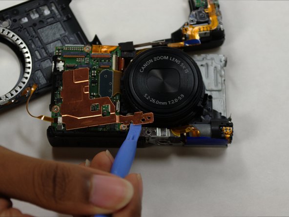

  13. Canon PowerShot S110 Lens Replacement: crwdns2935265:015crwdnd2935265:01crwdnd2935265:02crwdne2935265:0 Canon PowerShot S110 Lens Replacement: crwdns2935265:015crwdnd2935265:02crwdnd2935265:02crwdne2935265:0
    • Remove the Phillips screw holding the copper plate in place.
    • Use a prying tool to lift off the copper plate.
  14. Canon PowerShot S110 Lens Replacement: crwdns2935265:016crwdnd2935265:01crwdnd2935265:02crwdne2935265:0 Canon PowerShot S110 Lens Replacement: crwdns2935265:016crwdnd2935265:02crwdnd2935265:02crwdne2935265:0
    • Remove the indicated screw on the front facing side of the lens using a Philips screwdriver.
    • Next, remove the small attached ribbon by lifting up the clip and gently pulling the ribbon out.
