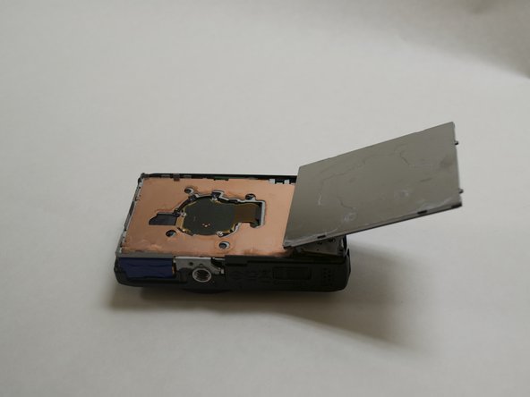

  3. Canon PowerShot S110 Display  Replacement: crwdns2935265:03crwdnd2935265:01crwdnd2935265:01crwdne2935265:0
    • Once the screws are removed, use a spudger to carefully detach the cover.

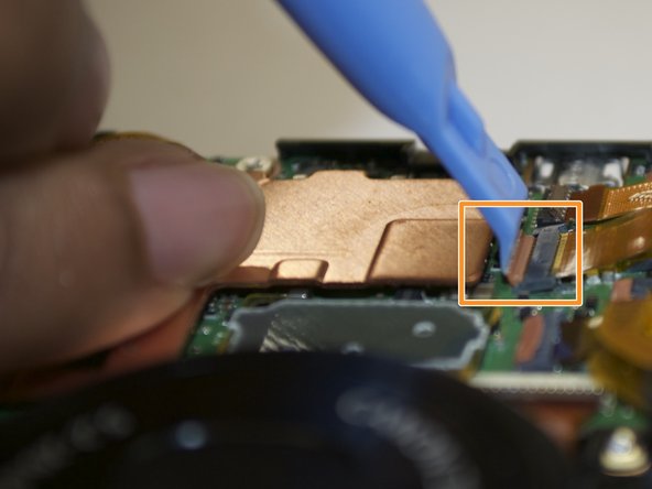

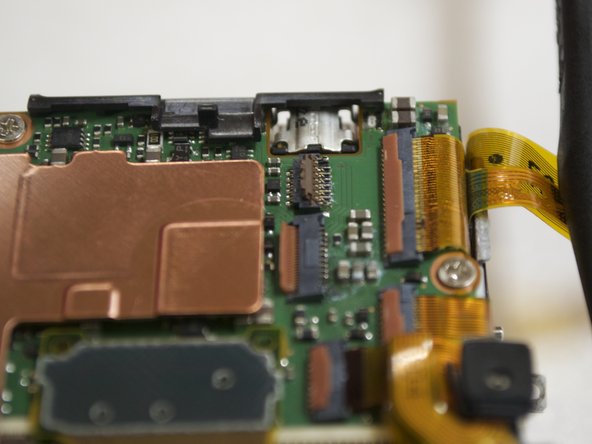

    • Using the spudger, flip the small tab that is holding down the logic ribbon located at the top left corner.
    • Flip the larger tab that is holding down the logic ribbon located directly to the right of the previous ribbon.
    • Detach both ribbons from the circuit board.
  8. Canon PowerShot S110 Display  Replacement: crwdns2935265:08crwdnd2935265:01crwdnd2935265:03crwdne2935265:0 Canon PowerShot S110 Display  Replacement: crwdns2935265:08crwdnd2935265:02crwdnd2935265:03crwdne2935265:0 Canon PowerShot S110 Display  Replacement: crwdns2935265:08crwdnd2935265:03crwdnd2935265:03crwdne2935265:0
    • Flip the tab and remove the last ribbon.
    • This ribbon is revealed after Step 7.
    • The display can now be lifted off the camera and the logic ribbons attached in the front can slide out.
    • Prepare your replacement display and move on to reassembly.

Oh My God, it works!!! Thanks for the great instructions, very clear and easy.
Thank you!!!
robertmadsen2000 - crwdns2934203:0crwdne2934203:0
Caution, the re-assembly is much more challenging than the dear-down. Masking tape (to temporarily hold the screen and func. set dial assembly in place while attaching the ribbon cables), tooth picks (the ends fit nicely in the ribbon cable holes) and a small plastic putty knife (for raising cable hold-downs) nay come in handy. You will find that the camera face has a ribbon cable for the control ring. When reassembling, note that there are anchor nobs over which holes in the cables go - front side of camera. Reinserting the func set cable under the control ring after attaching the screen cables is difficult (tight fit). Try inserting tooth picks to make room. My new screen cost $30 from D H Cameras on eBay.
