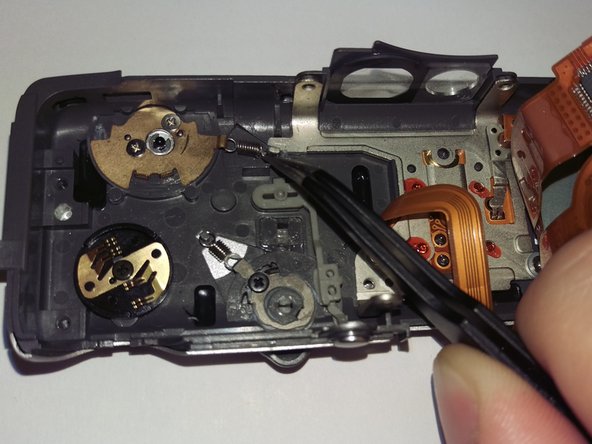

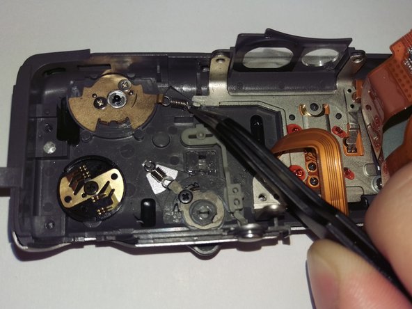

  6. Canon PowerShot G3 Zoom Control Spring Replacement: crwdns2935265:06crwdnd2935265:01crwdnd2935265:02crwdne2935265:0 Canon PowerShot G3 Zoom Control Spring Replacement: crwdns2935265:06crwdnd2935265:02crwdnd2935265:02crwdne2935265:0
    • With the top panel and metal plate removed, locate the zoom control on the underside of the panel (located on the forward left side if the panel is oriented similarly to the first image.) It will be located directly under the metal plate and circuit ribbon that was removed in the previous step.
    • Once the zoom control is located, remove the faulty zoom control spring from the metal pegs on the panel and zoom control.
  7. Canon PowerShot G3 Zoom Control Spring Replacement: crwdns2935265:07crwdnd2935265:01crwdnd2935265:02crwdne2935265:0 Canon PowerShot G3 Zoom Control Spring Replacement: crwdns2935265:07crwdnd2935265:02crwdnd2935265:02crwdne2935265:0
    • Replace the zoom control spring with a comparable spring, attaching the loop ends to the same metal pegs to which the previous spring was attached (on the panel and zoom control.)
