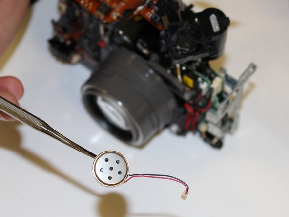

    • You should now be able to see how the capacitor/speaker housing slides out of the frame.
  8. Canon PowerShot G3 Speaker Replacement: crwdns2935265:08crwdnd2935265:01crwdnd2935265:02crwdne2935265:0 Canon PowerShot G3 Speaker Replacement: crwdns2935265:08crwdnd2935265:02crwdnd2935265:02crwdne2935265:0
    • Disconnect the speaker wires from the camera, then use a small flat head screw driver to lift the speaker out of its housing.
    • Order a new speaker from the manufacturer or take it to a local electronics store to see if they have one.
