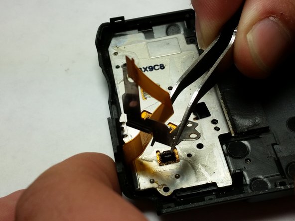

    1. Canon PowerShot G11 Rear Dial Replacement, Rear Dial: crwdns2935265:09crwdnd2935265:01crwdnd2935265:01crwdne2935265:0
      • Remove the plastic covering of the left side of the rear case interior.
    2. Canon PowerShot G11 Rear Dial Replacement: crwdns2935265:010crwdnd2935265:01crwdnd2935265:01crwdne2935265:0
      • Remove the four screws that are now accessible with the removal of the plastic covering them.
    3. Canon PowerShot G11 Rear Dial Replacement: crwdns2935265:011crwdnd2935265:01crwdnd2935265:02crwdne2935265:0 Canon PowerShot G11 Rear Dial Replacement: crwdns2935265:011crwdnd2935265:02crwdnd2935265:02crwdne2935265:0
      • After the screws are removed, pull the metal bracket out of the camera.
    4. Canon PowerShot G11 Rear Dial Replacement: crwdns2935265:012crwdnd2935265:01crwdnd2935265:01crwdne2935265:0
      • Push the dial out from the other side of the cover.
    5. Canon PowerShot G11 Rear Dial Replacement: crwdns2935265:013crwdnd2935265:01crwdnd2935265:01crwdne2935265:0
      • Remove the dial from the case completely.
