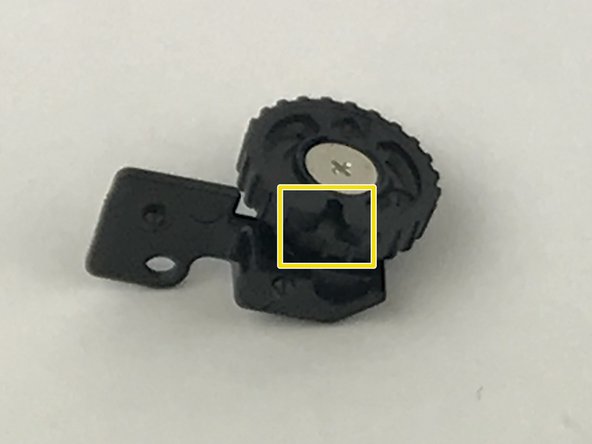

  7. Canon PowerShot G1 X View Finder Zoom Replacement, View Finder Zoom: crwdns2935265:07crwdnd2935265:01crwdnd2935265:02crwdne2935265:0 Canon PowerShot G1 X View Finder Zoom Replacement, View Finder Zoom: crwdns2935265:07crwdnd2935265:02crwdnd2935265:02crwdne2935265:0
    • Locate the view finder zoom on the back of the camera.
    • Remove the screw using a Phillips #000 screwdriver.
    • Be careful, the viewfinder zoom wheel can fall if the camera is oriented vertically.
    • To remove the viewfinder wheel, pull it to the left and away from the camera.
  8. Canon PowerShot G1 X View Finder Zoom Replacement: crwdns2935265:08crwdnd2935265:01crwdnd2935265:02crwdne2935265:0 Canon PowerShot G1 X View Finder Zoom Replacement: crwdns2935265:08crwdnd2935265:02crwdnd2935265:02crwdne2935265:0
    • Locate the viewfinder zoom pin seen in the first image.
    • Orient the viewfinder zoom pin to the same orientation as in the first image.
    • When reinstalling the viewfinder wheel, orient the notch in the viewfinder zoom wheel seen in the second image with the pin seen in the first image.
    • This will allow for the full range of motion of the viewfinder zoom wheel. Improper orientation will lead to a lower range of motion which can cause damage to the viewfinder.
