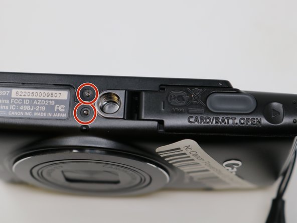

  3. Canon PowerShot ELPH330 HS Camera  Repair LCD Screen  Replacement: crwdns2935265:03crwdnd2935265:01crwdnd2935265:01crwdne2935265:0
    • Remove the two screws on the bottom of the camera with a Phillips #00 screwdriver.

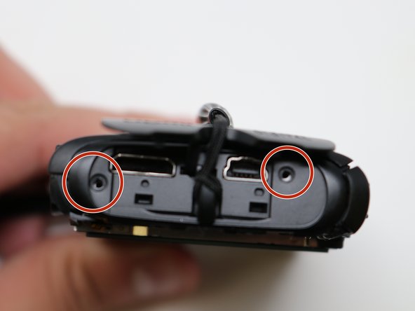

  4. Canon PowerShot ELPH330 HS Camera  Repair LCD Screen  Replacement: crwdns2935265:04crwdnd2935265:01crwdnd2935265:01crwdne2935265:0
    • Remove the two screws on the right side with a Phillips #00 screwdriver.

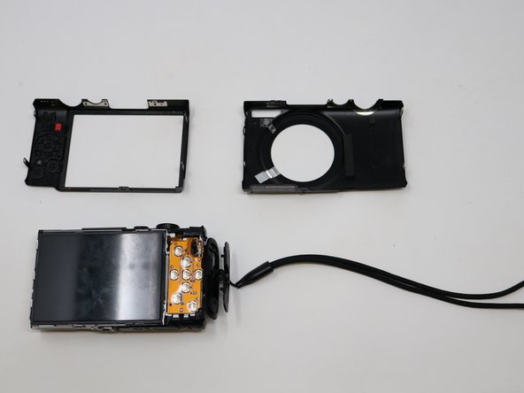

  5. Canon PowerShot ELPH330 HS Camera  Repair LCD Screen  Replacement: crwdns2935265:05crwdnd2935265:01crwdnd2935265:01crwdne2935265:0
    • Using your fingers, carefully pry the case apart at the seam.
  6. Canon PowerShot ELPH330 HS Camera  Repair LCD Screen  Replacement: crwdns2935265:06crwdnd2935265:01crwdnd2935265:02crwdne2935265:0 Canon PowerShot ELPH330 HS Camera  Repair LCD Screen  Replacement: crwdns2935265:06crwdnd2935265:02crwdnd2935265:02crwdne2935265:0
    • Flip the camera over so that the lens is facing you.
    • Disconnect the highlighted port from the motherboard.
  7. Canon PowerShot ELPH330 HS Camera  Repair LCD Screen  Replacement: crwdns2935265:07crwdnd2935265:01crwdnd2935265:02crwdne2935265:0 Canon PowerShot ELPH330 HS Camera  Repair LCD Screen  Replacement: crwdns2935265:07crwdnd2935265:02crwdnd2935265:02crwdne2935265:0

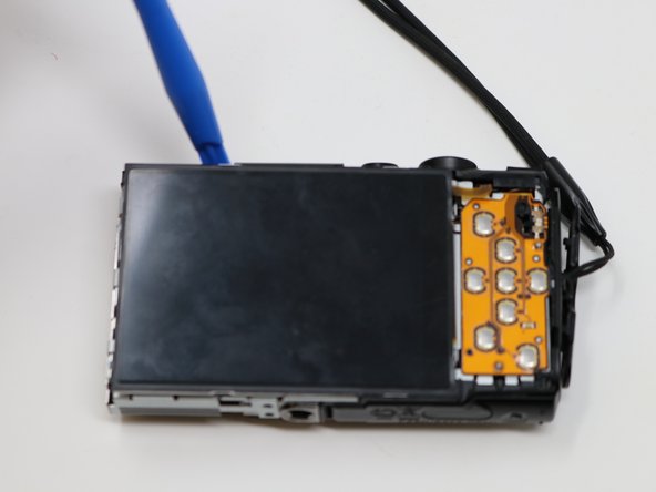

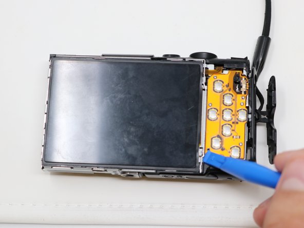

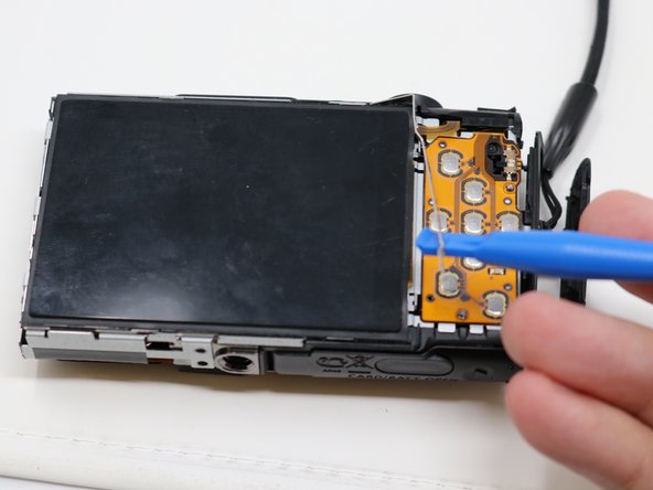

    • Remove the bracket around the LCD screen.
  8. Canon PowerShot ELPH330 HS Camera  Repair LCD Screen  Replacement: crwdns2935265:08crwdnd2935265:01crwdnd2935265:01crwdne2935265:0
    • Using the spudger, carefully pry the top to remove the LCD screen.
