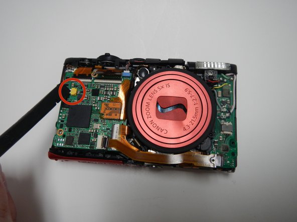

    • Disconnect the small cable from the yellow port on the motherboard
  8. Canon PowerShot ELPH 300HS Power Button Replacement: crwdns2935265:09crwdnd2935265:01crwdnd2935265:01crwdne2935265:0
    • Disconnect the small cable from the blue port on the motherboard
  9. Canon PowerShot ELPH 300HS Power Button Replacement: crwdns2935265:010crwdnd2935265:01crwdnd2935265:01crwdne2935265:0

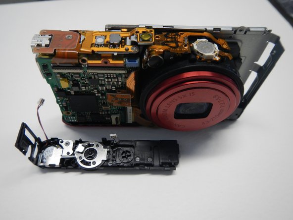

    • Lift the plastic over the HDMI port on the side of the camera
  10. Canon PowerShot ELPH 300HS Power Button Replacement: crwdns2935265:011crwdnd2935265:01crwdnd2935265:02crwdne2935265:0 Canon PowerShot ELPH 300HS Power Button Replacement: crwdns2935265:011crwdnd2935265:02crwdnd2935265:02crwdne2935265:0
    • Lift from the back of the camera, angling forward and pull off to remove the power button assembly
