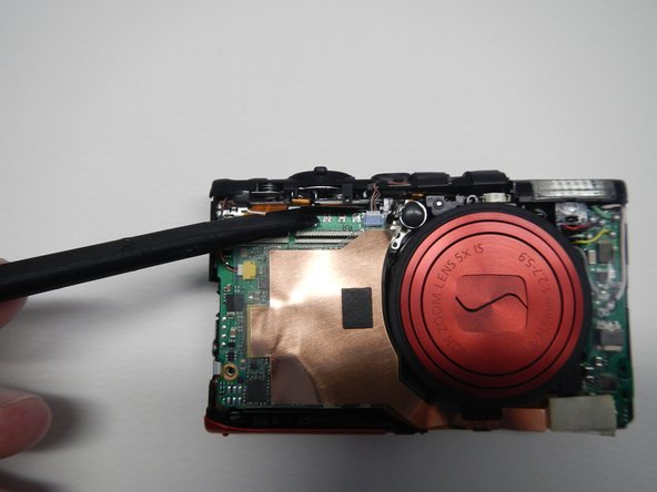

    • Disconnect the copper ribbon next to the blue port on the motherboard
    • To remove ribbon cable, gently lift the black tab with a flat head screwdriver. Lift from the top of the camera towards the bottom. This releases the cable. Be gentle, as the cables are fragile.

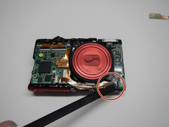

    • Remove the ribbon wire attached at the bottom right corner of the front of the camera. You do NOT need to remove this from the motherboard.

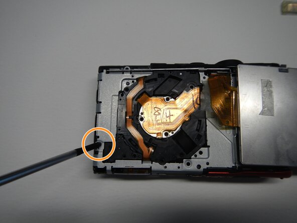

    • Locate the screws on silver panel that was behind the LCD screen, after removing the screen.
    • Unscrew the screw on the lower left part of the silver part of the back under where the LCD screen was.
    • Unscrew the screw on the top of the silver part of the back
  13. Canon PowerShot ELPH 300HS Lens Zoom Unit Replacement: crwdns2935265:015crwdnd2935265:01crwdnd2935265:03crwdne2935265:0 Canon PowerShot ELPH 300HS Lens Zoom Unit Replacement: crwdns2935265:015crwdnd2935265:02crwdnd2935265:03crwdne2935265:0 Canon PowerShot ELPH 300HS Lens Zoom Unit Replacement: crwdns2935265:015crwdnd2935265:03crwdnd2935265:03crwdne2935265:0

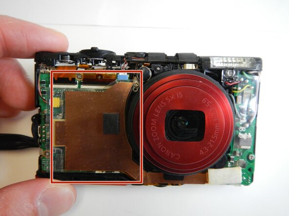

    • Remove the top copper ribbon (for USB port) by gently prying it from the motherboard with the spudger.
    • Remove the center copper ribbon (for CCD) using the same method as above.
    • Remove the lower right copper ribbon as in step one.

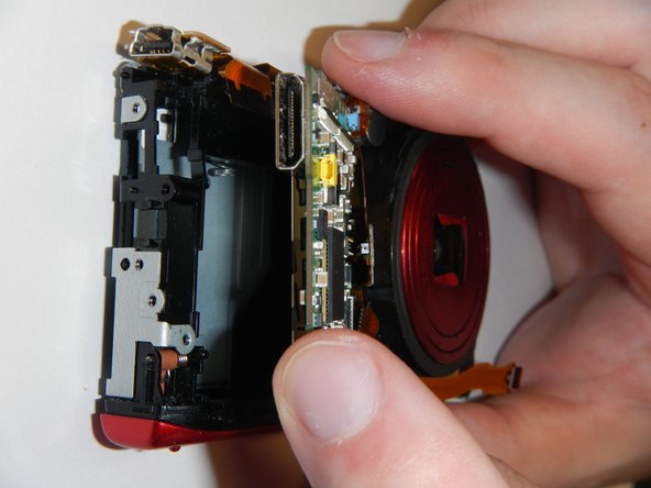

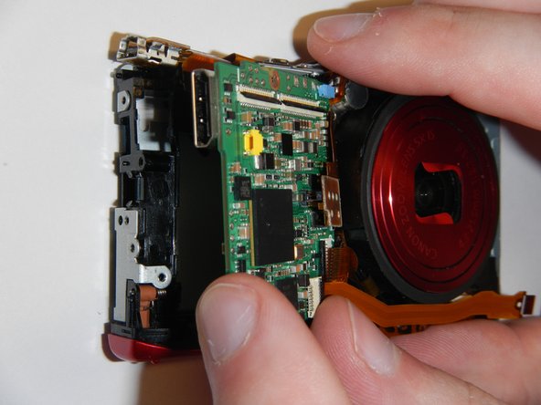

    • Remove the top screw on the motherboard. (2.5 mm).
    • Remove the screw in the bottom left of the motherboard. (2.5 mm).
    • Remove the screw located underneath the bottom copper ribbon. (3.0 mm).
  16. Canon PowerShot ELPH 300HS Lens Zoom Unit Replacement: crwdns2935265:018crwdnd2935265:01crwdnd2935265:03crwdne2935265:0 Canon PowerShot ELPH 300HS Lens Zoom Unit Replacement: crwdns2935265:018crwdnd2935265:02crwdnd2935265:03crwdne2935265:0 Canon PowerShot ELPH 300HS Lens Zoom Unit Replacement: crwdns2935265:018crwdnd2935265:03crwdnd2935265:03crwdne2935265:0
    • Remove the motherboard from the frame by gently grasping the outside edge and pulling away.

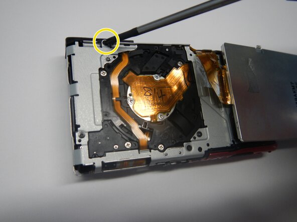

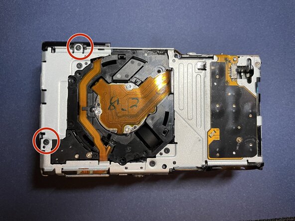

  17. Canon PowerShot ELPH 300HS Lens Zoom Unit Replacement: crwdns2935265:019crwdnd2935265:01crwdnd2935265:03crwdne2935265:0 Canon PowerShot ELPH 300HS Lens Zoom Unit Replacement: crwdns2935265:019crwdnd2935265:02crwdnd2935265:03crwdne2935265:0 Canon PowerShot ELPH 300HS Lens Zoom Unit Replacement: crwdns2935265:019crwdnd2935265:03crwdnd2935265:03crwdne2935265:0
    • On the back of the case, remove the top left corner screw. (3.0 mm).
    • Remove the bottom right corner screw. (3.0 mm).
    • Lift the silver frame away from the zoom lens to separate the two.

There is a step missing between step 19 and step 20. The guide doesn't mention disconnecting the yellow and blue connectors at the top that are connected to the top control panel (with shutter release, power button, and zoom ring), then to remove the top control panel. The blue connector pulls out toward the top (use a small flat screwdriver) and the yellow connector pulls out toward the side (use an even smaller flat screwdriver). There is a small piece of plastic that holds the top control panel to the aluminum frame.

And how is the sensor accessed? At the top, it says this enables you to access the zoom assembly, but from these instructions and pics, it appears the sensor is internal to the zoom assembly. Is it actually possible to access the sensor and clean it?
CCxx - crwdns2934203:0crwdne2934203:0
Exactly, the title offers the access to the sensor to clean it, yet we only get the instructions to replace the entire zoom lens which comes with the sensor assembled. There are no further steps on how to disassemble the lens unit to get to the sensor itself. By the way, the article refers to the sensor as "CCD", however this camera uses BSI-CMOS sensor (not CCD, which is a different technology).
rmackowski - crwdns2934203:0crwdne2934203:0
The sensor is behind the metal plate held by 3 screws on the rear of the lens assy. Remove the screws to access the sensor and the IR filter. Is is very unlikely that dust has entered here because it is sealed on the inside by a rubber gasket and clamped on the other side. Mine had dust below the IR filter that was blown out by extending the lens (with the lens assy removed) There are several openings around the lens that allow air to enter and dust to exit. The 3 screws on the sensor plate must be torqued well to make the camera focus at infinity with the zoom at minimum. (Found out the hard way) <grin>
