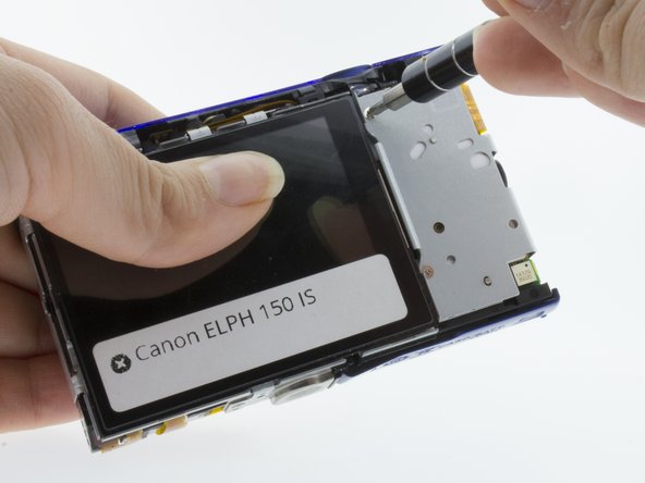

    • Once the back plate and face plate have been removed, you can begin to remove the LCD screen.
  8. Canon PowerShot ELPH 150 IS LCD Screen Replacement: crwdns2935265:08crwdnd2935265:01crwdnd2935265:02crwdne2935265:0 Canon PowerShot ELPH 150 IS LCD Screen Replacement: crwdns2935265:08crwdnd2935265:02crwdnd2935265:02crwdne2935265:0
    • Turn the camera so that the LCD screen is facing you.
    • Remove the 2 screws on the silver plate to the right of the screen using the PH00 screw driver head.
  9. Canon PowerShot ELPH 150 IS LCD Screen Replacement: crwdns2935265:09crwdnd2935265:01crwdnd2935265:03crwdne2935265:0 Canon PowerShot ELPH 150 IS LCD Screen Replacement: crwdns2935265:09crwdnd2935265:02crwdnd2935265:03crwdne2935265:0 Canon PowerShot ELPH 150 IS LCD Screen Replacement: crwdns2935265:09crwdnd2935265:03crwdnd2935265:03crwdne2935265:0
    • Gently remove the silver plate by pulling it back towards you as you hold the camera firmly in the other hand.
    • With the plate removed you will be able to locate the electrical ribbon that connect the LCD screen to the device.
    • You will also be able to lift the LCD screen away from the motherboard cover as picture in image 3. It will still be attached via electrical ribbon but can be moved to the side so you can access the clip underneath.
