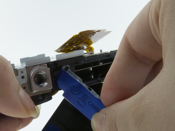

  4. Canon PowerShot ELPH 150 IS Card/Battery Door Replacement: crwdns2935265:04crwdnd2935265:01crwdnd2935265:02crwdne2935265:0 Canon PowerShot ELPH 150 IS Card/Battery Door Replacement: crwdns2935265:04crwdnd2935265:02crwdnd2935265:02crwdne2935265:0
    • With the backplate removed, turn the camera so that the CARD/BATT. OPEN door is face up and to the right. Press down on the door as you slide it to the right. You should hear a click which indicates that the door is unlocked and will freely open.

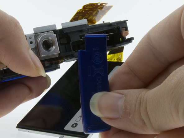

  5. Canon PowerShot ELPH 150 IS Card/Battery Door Replacement: crwdns2935265:05crwdnd2935265:01crwdnd2935265:03crwdne2935265:0 Canon PowerShot ELPH 150 IS Card/Battery Door Replacement: crwdns2935265:05crwdnd2935265:02crwdnd2935265:03crwdne2935265:0 Canon PowerShot ELPH 150 IS Card/Battery Door Replacement: crwdns2935265:05crwdnd2935265:03crwdnd2935265:03crwdne2935265:0
    • With the CARD/BATT. OPEN door open, and the backplate off, gently pull the door from a 90 degree angle back towards you. Once you hear a pop ( a sign that one side pin has released), you can slide the door away from you to release the pin on the other side as well. Remove door.
