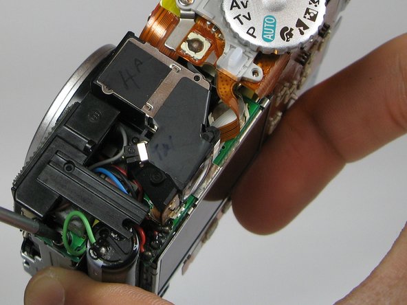

    1. Canon PowerShot A75 Flash Unit Replacement, Flash Unit: crwdns2935265:015crwdnd2935265:01crwdnd2935265:03crwdne2935265:0 Canon PowerShot A75 Flash Unit Replacement, Flash Unit: crwdns2935265:015crwdnd2935265:02crwdnd2935265:03crwdne2935265:0 Canon PowerShot A75 Flash Unit Replacement, Flash Unit: crwdns2935265:015crwdnd2935265:03crwdnd2935265:03crwdne2935265:0
      • Rotate the camera such that the flash unit and capacitor are facing you.
      • DO NOT touch the capacitor because it may shock you.
      • Remove the 3.5mm screw located between the flash unit and the capacitor.
    2. Canon PowerShot A75 Flash Unit Replacement: crwdns2935265:016crwdnd2935265:01crwdnd2935265:02crwdne2935265:0 Canon PowerShot A75 Flash Unit Replacement: crwdns2935265:016crwdnd2935265:02crwdnd2935265:02crwdne2935265:0
      • Snap flash unit out of place with your fingers.
      • Do not proceed to the next step unless you have previous soldering experience because you can damage the flash unit if you are not careful.
      • Unsolder the five wires connected to the flash unit in order to remove it.
