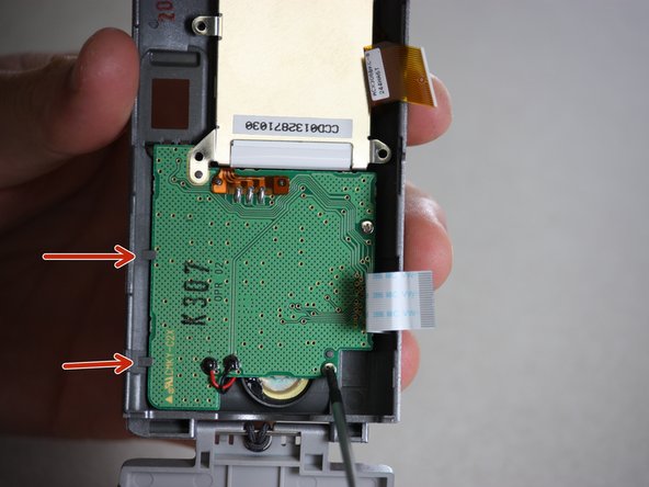

  12. Canon PowerShot A200 Motherboard Replacement, Motherboard: crwdns2935265:012crwdnd2935265:01crwdnd2935265:03crwdne2935265:0 Canon PowerShot A200 Motherboard Replacement, Motherboard: crwdns2935265:012crwdnd2935265:02crwdnd2935265:03crwdne2935265:0 Canon PowerShot A200 Motherboard Replacement, Motherboard: crwdns2935265:012crwdnd2935265:03crwdnd2935265:03crwdne2935265:0
    • Follow the prerequisite instructions for Disassembling the Canon PowerShot A200 Case and for the Canon PowerShot A200 LCD Display Replacement.
    • Once the LCD Display has been removed, use the soldering kit to desolder the red and black connections attached to the green motherboard.
    • Use the Phillips head screwdriver to remove the two screws in the motherboard. Set the screws aside.
  13. Canon PowerShot A200 Motherboard Replacement: crwdns2935265:013crwdnd2935265:01crwdnd2935265:02crwdne2935265:0 Canon PowerShot A200 Motherboard Replacement: crwdns2935265:013crwdnd2935265:02crwdnd2935265:02crwdne2935265:0
    • Use the plastic opening tool to carefully pry the motherboard out of its place, proceeding from the indicated points. Pull gently, as to not destroy any of the other internal parts of the camera.
    • Pull gently, as to not destroy any of the other internal parts of the camera.
    • Insert the new green motherboard in place, making sure it fits snugly under the grey tabs at the edge of the camera case.
    • Reassemble the camera following these instructions in reverse order, as well as the instructions in the prerequisite guides.
