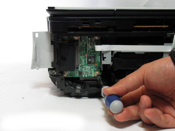

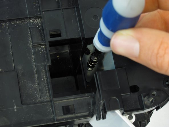

  24. Canon Pixma MP480 Data Port Replacement, Data Port: crwdns2935265:024crwdnd2935265:01crwdnd2935265:02crwdne2935265:0 Canon Pixma MP480 Data Port Replacement, Data Port: crwdns2935265:024crwdnd2935265:02crwdnd2935265:02crwdne2935265:0
    • Remove the 7.5 mm screw using the Phillips #1 screwdriver.
  25. Canon Pixma MP480 Data Port Replacement: crwdns2935265:025crwdnd2935265:01crwdnd2935265:02crwdne2935265:0 Canon Pixma MP480 Data Port Replacement: crwdns2935265:025crwdnd2935265:02crwdnd2935265:02crwdne2935265:0
    • Remove the five 3.5 mm screws using the Phillips #1 screwdriver.
  26. Canon Pixma MP480 Data Port Replacement: crwdns2935265:026crwdnd2935265:01crwdnd2935265:01crwdne2935265:0
    • Remove the small plastic clip using the spudger.
  27. Canon Pixma MP480 Data Port Replacement: crwdns2935265:027crwdnd2935265:01crwdnd2935265:01crwdne2935265:0
    • Pull the plastic inserts out of the holes in the top and bottom.
  28. Canon Pixma MP480 Data Port Replacement: crwdns2935265:028crwdnd2935265:01crwdnd2935265:01crwdne2935265:0
    • Remove the board from the printer by pulling the board towards the back of the printer.
    • This requires effort and time as the board comes out slowly.
