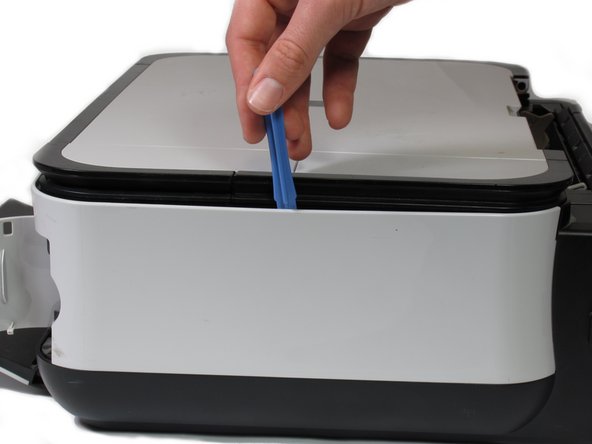

    6. Canon Pixma MP480 Buttons Replacement: crwdns2935265:06crwdnd2935265:01crwdnd2935265:02crwdne2935265:0 Canon Pixma MP480 Buttons Replacement: crwdns2935265:06crwdnd2935265:02crwdnd2935265:02crwdne2935265:0

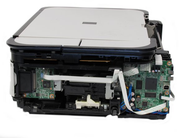

      • Pry open the side cover with the plastic opening tool.
    7. Canon Pixma MP480 Buttons Replacement: crwdns2935265:07crwdnd2935265:01crwdnd2935265:02crwdne2935265:0 Canon Pixma MP480 Buttons Replacement: crwdns2935265:07crwdnd2935265:02crwdnd2935265:02crwdne2935265:0
      • Flip the printer over so that the bottom of the printer is facing you.
      • Use the plastic opening tool to remove the corner of the side panel from the plastic pin.
    8. Canon Pixma MP480 Buttons Replacement: crwdns2935265:08crwdnd2935265:01crwdnd2935265:02crwdne2935265:0 Canon Pixma MP480 Buttons Replacement: crwdns2935265:08crwdnd2935265:02crwdnd2935265:02crwdne2935265:0
      • Use the plastic opening tool to loosen the side panel from the bottom of the printer.

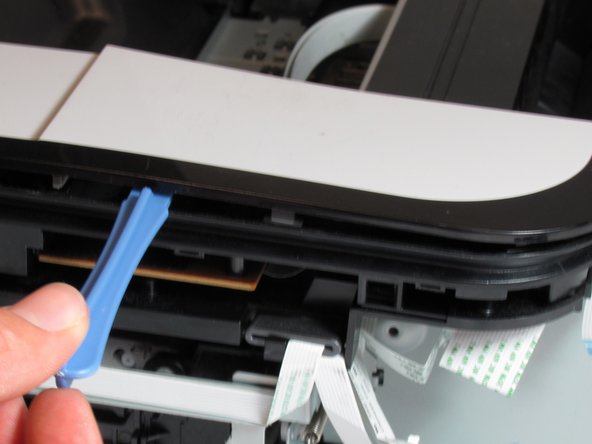

    1. Canon Pixma MP480 Buttons Replacement, LCD: crwdns2935265:09crwdnd2935265:01crwdnd2935265:02crwdne2935265:0 Canon Pixma MP480 Buttons Replacement, LCD: crwdns2935265:09crwdnd2935265:02crwdnd2935265:02crwdne2935265:0
      • Using the plastic opening tool, pry off the top cover of the LCD assembly.
      • Pry around the front and side edges for the easiest removal.

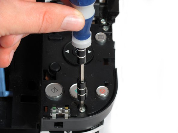

    3. Canon Pixma MP480 Buttons Replacement: crwdns2935265:014crwdnd2935265:01crwdnd2935265:02crwdne2935265:0 Canon Pixma MP480 Buttons Replacement: crwdns2935265:014crwdnd2935265:02crwdnd2935265:02crwdne2935265:0
      • Remove the five 7.7 mm screws using a Phillips #1 screwdriver.

    5. Canon Pixma MP480 Buttons Replacement: crwdns2935265:016crwdnd2935265:01crwdnd2935265:02crwdne2935265:0 Canon Pixma MP480 Buttons Replacement: crwdns2935265:016crwdnd2935265:02crwdnd2935265:02crwdne2935265:0
      • Remove the two 7.8 mm screws using a Phillips #1 screwdriver.

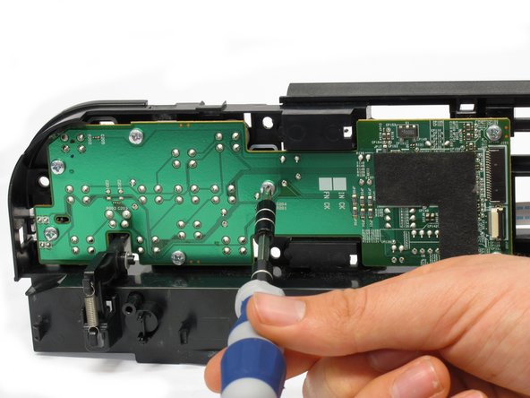

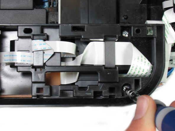

    10. Canon Pixma MP480 Buttons Replacement: crwdns2935265:021crwdnd2935265:01crwdnd2935265:02crwdne2935265:0 Canon Pixma MP480 Buttons Replacement: crwdns2935265:021crwdnd2935265:02crwdnd2935265:02crwdne2935265:0
      • Remove the seven 8.7 mm screws using the Phillips #1 screwdriver.

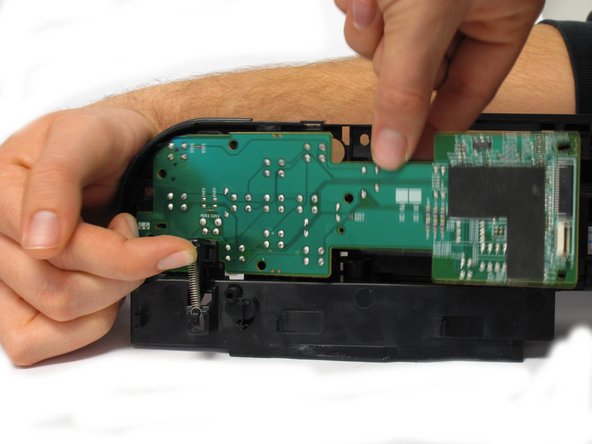

    11. Canon Pixma MP480 Buttons Replacement: crwdns2935265:022crwdnd2935265:01crwdnd2935265:03crwdne2935265:0 Canon Pixma MP480 Buttons Replacement: crwdns2935265:022crwdnd2935265:02crwdnd2935265:03crwdne2935265:0 Canon Pixma MP480 Buttons Replacement: crwdns2935265:022crwdnd2935265:03crwdnd2935265:03crwdne2935265:0
      • Locate the spring that holds the PCB in place on the bottom left of the plastic button assembly.
      • Gently lift the spring and pull the board out of its plastic button assembly.

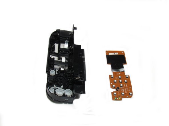

    12. Canon Pixma MP480 Buttons Replacement: crwdns2935265:023crwdnd2935265:01crwdnd2935265:01crwdne2935265:0
      • Remove the buttons from the plastic button assembly.
