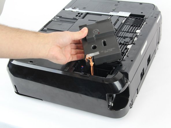

    • There are two tabs on the left and right side of the power supply. Push them away from the power supply and unclasp them prior to removal.
  2. Canon Pixma MG7720 Power Supply Replacement: crwdns2935265:02crwdnd2935265:01crwdnd2935265:02crwdne2935265:0 Canon Pixma MG7720 Power Supply Replacement: crwdns2935265:02crwdnd2935265:02crwdnd2935265:02crwdne2935265:0
    • Remove the power supply by pulling it up from the printer.
    • Use an iFixit Opening Tool if you are having difficulty.
    • Pull it out completely so that it is only still attached by an orange cable.

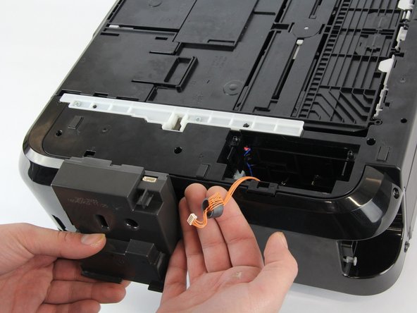

    • Completely remove the tape holding the cable in place.
    • Pull the orange cable out of its socket to fully detach the power supply.
    • If you are having trouble removing the cable, an iFixit Opening Tool can be used.
