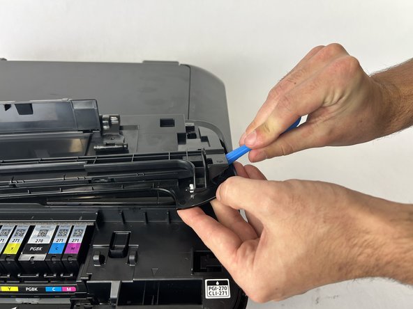

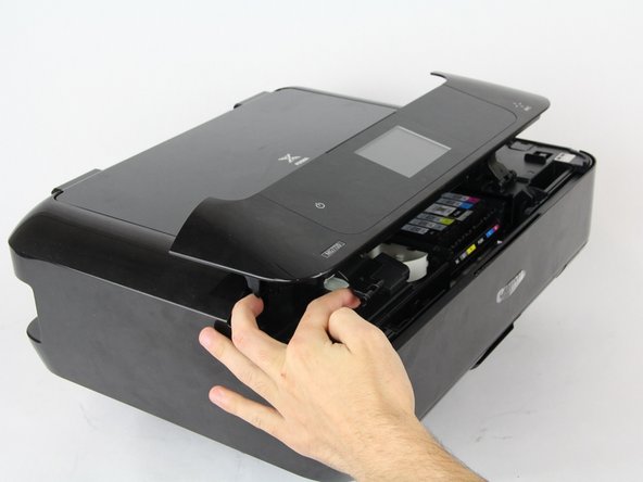

    • Open the front part of the printer and use your finger to depress the tab behind the front hinge in order to release it.
    • Repeat this with both the left and right front hinges.

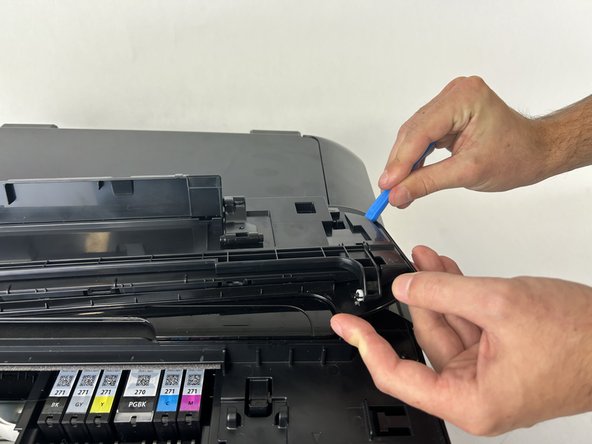

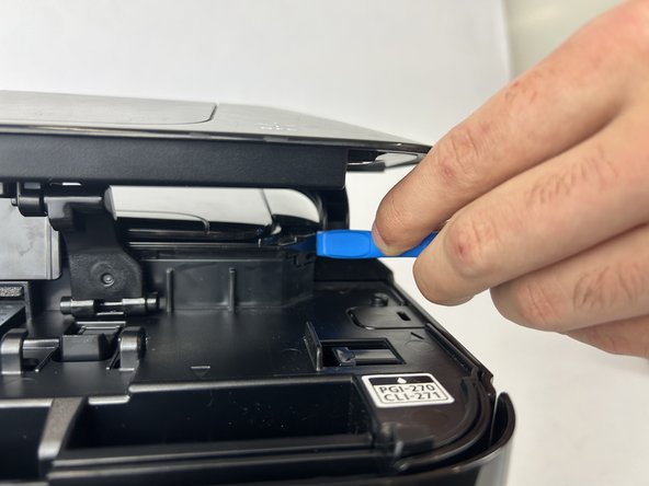

    • Use the iFixit Opening Tool to pull the hinge away from the printer, then pull the hinge forward.
    • Repeat this with both of the rear hinges.

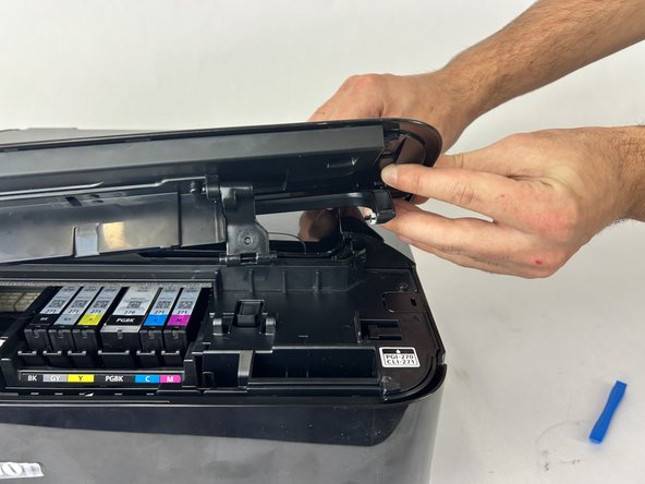

    • Use the iFixit Opening Tool to pull up on the back cover.
    • Use the tool lightly on both ends of the back cover to prevent bending.

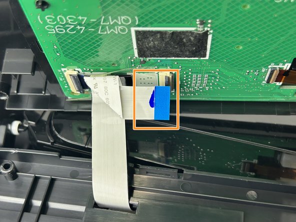

    • Remove the tape on the connector.
    • Unplug it from both terminals by flipping up the tabs and pulling it out.
