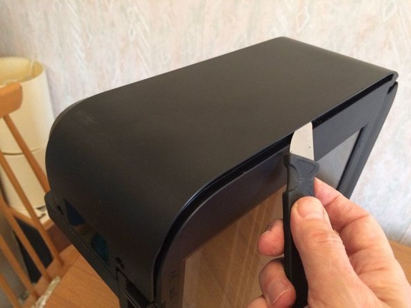

    2. Canon Pixma MG3550 Disassembly, Control panel cover removal: crwdns2935265:02crwdnd2935265:01crwdnd2935265:01crwdne2935265:0
      • Using a jimmy (or similar tool), release the clips around the edge of the control panel cover, then lift off the cover.
