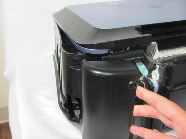

  3. Canon PIXMA MP620B USB Reader Replacement, Pull off black side panel: crwdns2935265:03crwdnd2935265:01crwdnd2935265:02crwdne2935265:0 Canon PIXMA MP620B USB Reader Replacement, Pull off black side panel: crwdns2935265:03crwdnd2935265:02crwdnd2935265:02crwdne2935265:0
    • There is a tab you will have to push down to remove the part.
    • Once the tab is released, gently lift the cover away from the rest of the device to disengage the clips.
    • You will hear some snapping. Don't panic: this is just the clips un-clipping.
  4. Canon PIXMA MP620B USB Reader Replacement, Take off the black side panel: crwdns2935265:04crwdnd2935265:01crwdnd2935265:01crwdne2935265:0
    • After unclipping all the hooks, pull off the black side panel to reveal the inner circuit boards.
