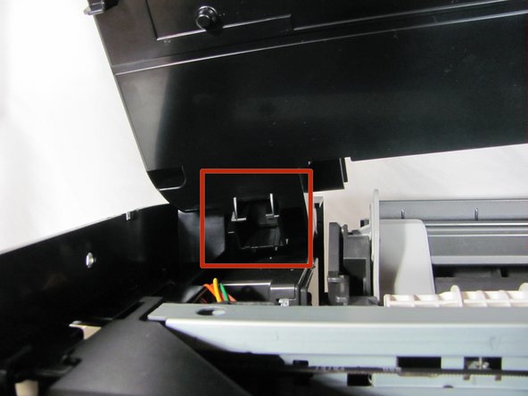

  3. Canon PIXMA MP620B Ink Head Replacement: crwdns2935265:03crwdnd2935265:01crwdnd2935265:01crwdne2935265:0
    • Unhook the lid support by sliding the hook down and to the left. Make sure the support is fully disconnected before proceeding.

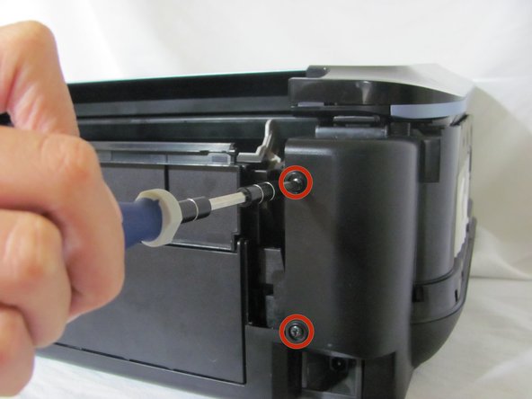

  4. Canon PIXMA MP620B Ink Head Replacement: crwdns2935265:04crwdnd2935265:01crwdnd2935265:02crwdne2935265:0 Canon PIXMA MP620B Ink Head Replacement: crwdns2935265:04crwdnd2935265:02crwdnd2935265:02crwdne2935265:0
    • Remove the four black screws on the back panels from both the left and right side.

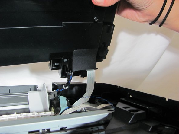

  5. Canon PIXMA MP620B Ink Head Replacement: crwdns2935265:05crwdnd2935265:01crwdnd2935265:03crwdne2935265:0 Canon PIXMA MP620B Ink Head Replacement: crwdns2935265:05crwdnd2935265:02crwdnd2935265:03crwdne2935265:0 Canon PIXMA MP620B Ink Head Replacement: crwdns2935265:05crwdnd2935265:03crwdnd2935265:03crwdne2935265:0
    • Remove the scanner by pulling the side panels out until the scanner pin is free. Set the scanner aside.
    • The scanner will still be attached with wires on the right side. Be careful not to yank the part away from the main body of the printer.

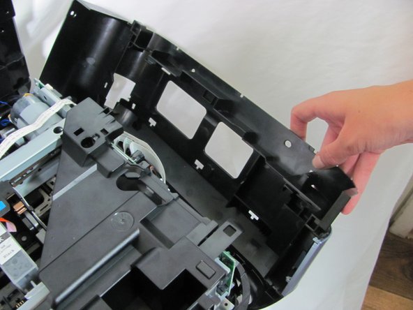

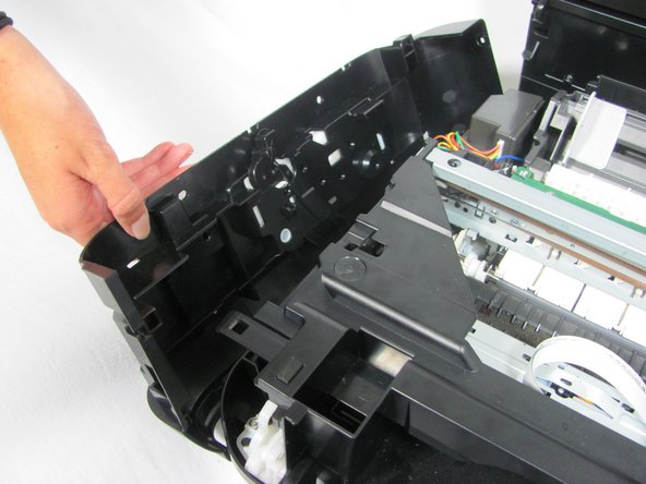

  6. Canon PIXMA MP620B Ink Head Replacement: crwdns2935265:06crwdnd2935265:01crwdnd2935265:02crwdne2935265:0 Canon PIXMA MP620B Ink Head Replacement: crwdns2935265:06crwdnd2935265:02crwdnd2935265:02crwdne2935265:0
    • Press down on the clip on the left side of the printer until it clicks, and pull the panel free.
  7. Canon PIXMA MP620B Ink Head Replacement: crwdns2935265:07crwdnd2935265:01crwdnd2935265:02crwdne2935265:0 Canon PIXMA MP620B Ink Head Replacement: crwdns2935265:07crwdnd2935265:02crwdnd2935265:02crwdne2935265:0
    • Press down on the clip on the right side panel until it clicks and then pull the panel free.

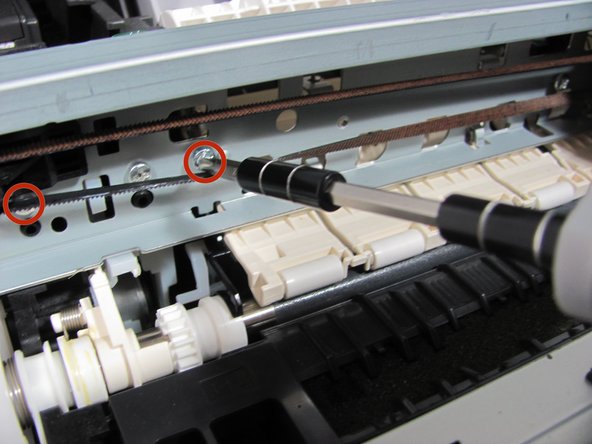

  9. Canon PIXMA MP620B Ink Head Replacement, Remove the three screws holding the top rear slider rail: crwdns2935265:09crwdnd2935265:01crwdnd2935265:02crwdne2935265:0 Canon PIXMA MP620B Ink Head Replacement, Remove the three screws holding the top rear slider rail: crwdns2935265:09crwdnd2935265:02crwdnd2935265:02crwdne2935265:0
    • Unscrew the three screws holding the rail.
