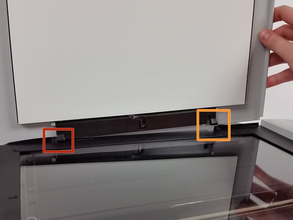

    • Lift scanning bed cover with one hand, and pry the right hinge inward using a plastic opening tool.
    • The cover will lift up and away from the printer.

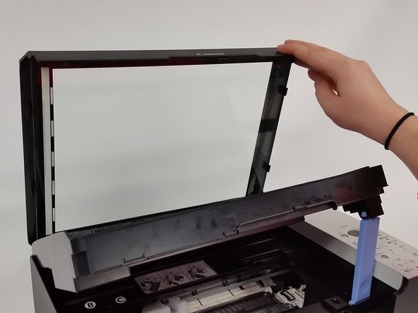

    • Lift the scan bed into the upright position.
    • Ensure the scanning unit support seats into the scanning unit support slot.
    • The four arrow markers located on the bottom edge of the scan bed mark the four tabs that must be released.
  3. Canon PIXMA MP190 Scan Bed Removal, Accessing Scan Bed: crwdns2935265:03crwdnd2935265:01crwdnd2935265:02crwdne2935265:0 Canon PIXMA MP190 Scan Bed Removal, Accessing Scan Bed: crwdns2935265:03crwdnd2935265:02crwdnd2935265:02crwdne2935265:0
    • Place a plastic opening tool at each of the four marking arrows.
    • The scan bed will detach from the scan bed unit. Lift scan bed glass upward to access the bottom surface of the glass.
