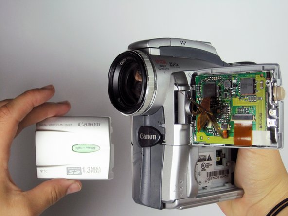

  9. Canon Optura 100MC LCD Screen and Glass Screen Replacement: crwdns2935265:09crwdnd2935265:01crwdnd2935265:01crwdne2935265:0
    • Disconnect the screen components from the main body of the camcorder by applying downward pressure near the circled hinge.
  10. Canon Optura 100MC LCD Screen and Glass Screen Replacement: crwdns2935265:010crwdnd2935265:01crwdnd2935265:01crwdne2935265:0
    • Remove the 4mm #00 Phillips screw connecting the LCD to the glass screen and lower casing.

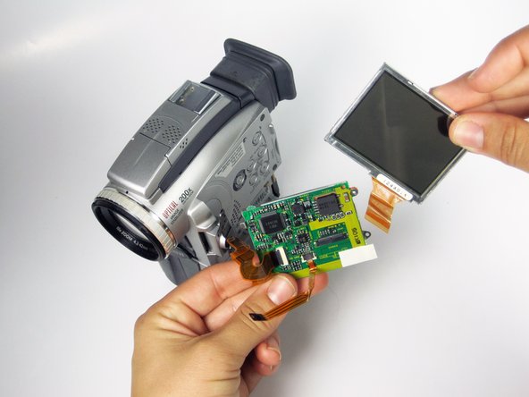

  12. Canon Optura 100MC LCD Screen and Glass Screen Replacement: crwdns2935265:012crwdnd2935265:01crwdnd2935265:02crwdne2935265:0 Canon Optura 100MC LCD Screen and Glass Screen Replacement: crwdns2935265:012crwdnd2935265:02crwdnd2935265:02crwdne2935265:0
    • Remove the glass screen from the LCD by lifting up on the cream colored hinge to disconnect the ribbon wire. Pull the glass screen away.
    • Replace the glass screen if it is cracked or damaged.

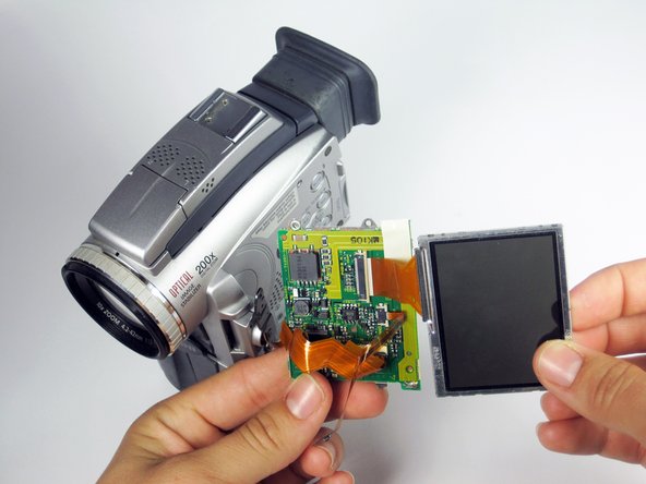

  13. Canon Optura 100MC LCD Screen and Glass Screen Replacement: crwdns2935265:013crwdnd2935265:01crwdnd2935265:01crwdne2935265:0
    • Remove the LCD by disconnecting the remaining two ribbon wires by lifting up the cream-colored gate and sliding the ribbon out of the black gate.
  14. Canon Optura 100MC LCD Screen and Glass Screen Replacement: crwdns2935265:014crwdnd2935265:01crwdnd2935265:01crwdne2935265:0
    • Replace the broken LCD with a new one.
