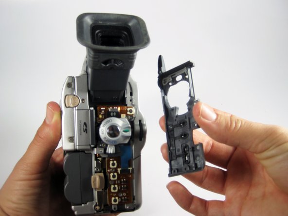

    3. Canon Optura 100MC Button Pad Replacement: crwdns2935265:07crwdnd2935265:01crwdnd2935265:02crwdne2935265:0 Canon Optura 100MC Button Pad Replacement: crwdns2935265:07crwdnd2935265:02crwdnd2935265:02crwdne2935265:0
      • Remove the plastic cover from the rear of the camcorder by gently pulling it towards you while holding the camera as shown.
      • The Battery Should be removed at this point, please ignore it in the picture.

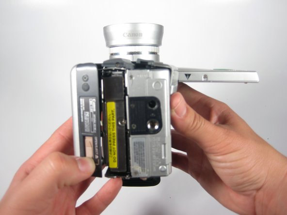

    7. Canon Optura 100MC Button Pad Replacement: crwdns2935265:011crwdnd2935265:01crwdnd2935265:02crwdne2935265:0 Canon Optura 100MC Button Pad Replacement: crwdns2935265:011crwdnd2935265:02crwdnd2935265:02crwdne2935265:0
      • Reorient the camera with the bottom facing you, LCD screen on the right, side panel on the left.
      • Open the tape deck by sliding the switch and moving the deck cover to the left as shown.

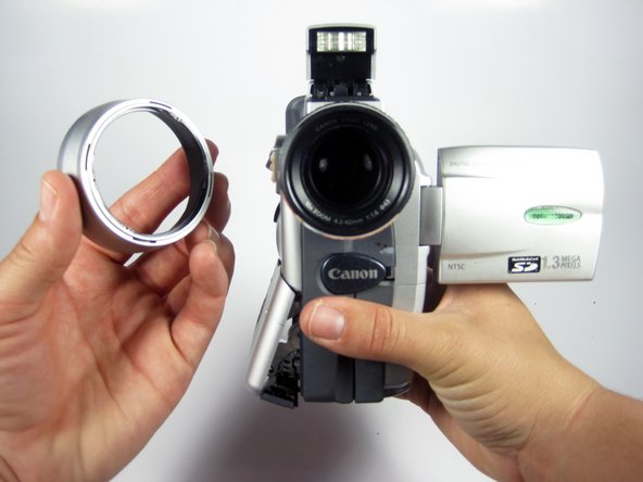

    10. Canon Optura 100MC Button Pad Replacement: crwdns2935265:014crwdnd2935265:01crwdnd2935265:02crwdne2935265:0 Canon Optura 100MC Button Pad Replacement: crwdns2935265:014crwdnd2935265:02crwdnd2935265:02crwdne2935265:0
      • To remove the camcorder lens hood, twist the hood to counterclockwise and it will come loose, then pull towards you.

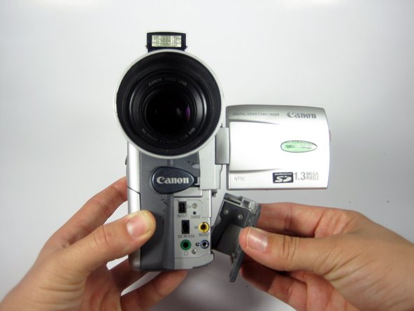

    11. Canon Optura 100MC Button Pad Replacement: crwdns2935265:015crwdnd2935265:01crwdnd2935265:02crwdne2935265:0 Canon Optura 100MC Button Pad Replacement: crwdns2935265:015crwdnd2935265:02crwdnd2935265:02crwdne2935265:0
      • Close the tape deck by gently pushing it toward the body of the camera.
      • Slide and remove the plastic cover on the bottom right, exposing the interface shown.

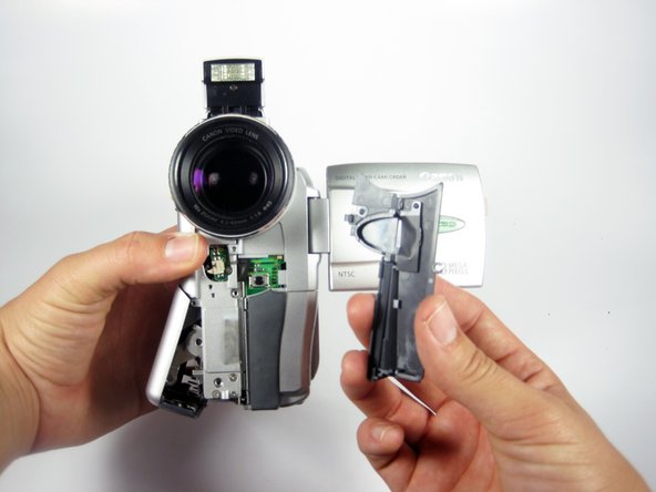

      • Reorient the camera with the lens facing you.
      • Gently pull the side panel of the camera to the right to remove.
      • Be aware that that there are wires connecting the cover to the body of the device, so the side cover will not come off entirely.
    17. Canon Optura 100MC Button Pad Replacement: crwdns2935265:021crwdnd2935265:01crwdnd2935265:01crwdne2935265:0
      • The side of the device should now be open as shown. Again, there are wire connections between the side cover and the body of the camcorder. Do not separate the two entirely!

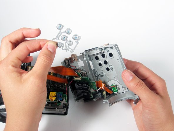

    6. Canon Optura 100MC Button Pad Replacement: crwdns2935265:027crwdnd2935265:01crwdnd2935265:02crwdne2935265:0 Canon Optura 100MC Button Pad Replacement: crwdns2935265:027crwdnd2935265:02crwdnd2935265:02crwdne2935265:0
      • Pull the button pad out of its chassis.
