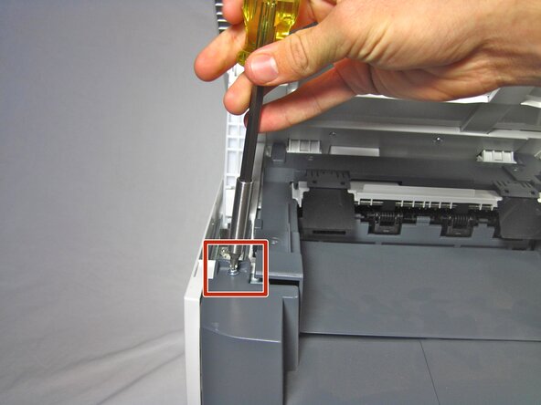

      • Lift the printer lid up as shown in the photo.
    2. Canon ImageCLASS MF4350d Transformer Replacement: crwdns2935265:02crwdnd2935265:01crwdnd2935265:02crwdne2935265:0 Canon ImageCLASS MF4350d Transformer Replacement: crwdns2935265:02crwdnd2935265:02crwdnd2935265:02crwdne2935265:0

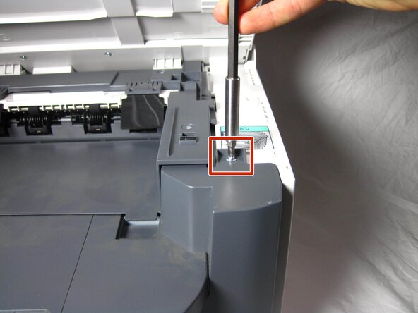

      • Locate and remove the two 10mm side screws. There is one on each side.
    3. Canon ImageCLASS MF4350d Transformer Replacement: crwdns2935265:03crwdnd2935265:01crwdnd2935265:02crwdne2935265:0 Canon ImageCLASS MF4350d Transformer Replacement: crwdns2935265:03crwdnd2935265:02crwdnd2935265:02crwdne2935265:0

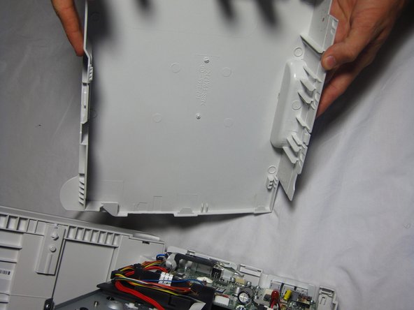

      • Unhook the plastic panel from the printer starting from the top.
      • You may need to wiggle the panel a bit to loosen it.
      • To remove the bottom part of the paneling gently lay the printer on its back.
      • The scanner lid needs to be supported when moving the printer

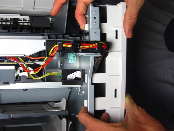

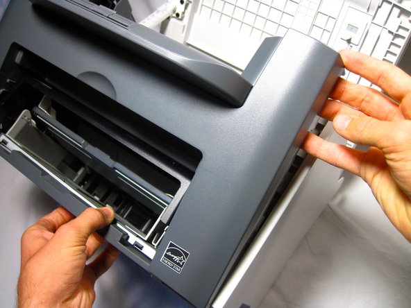

    1. Canon ImageCLASS MF4350d Transformer Replacement, Right Side Paneling: crwdns2935265:04crwdnd2935265:01crwdnd2935265:03crwdne2935265:0 Canon ImageCLASS MF4350d Transformer Replacement, Right Side Paneling: crwdns2935265:04crwdnd2935265:02crwdnd2935265:03crwdne2935265:0 Canon ImageCLASS MF4350d Transformer Replacement, Right Side Paneling: crwdns2935265:04crwdnd2935265:03crwdnd2935265:03crwdne2935265:0
      • Gently unhook the right side paneling (as looking at the printer's front face) from the printer.
      • Use a gentle back and forth motion to wiggle the hooks out.

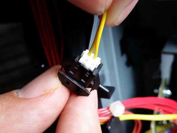

    1. Canon ImageCLASS MF4350d Transformer Replacement, Transformer: crwdns2935265:05crwdnd2935265:01crwdnd2935265:02crwdne2935265:0 Canon ImageCLASS MF4350d Transformer Replacement, Transformer: crwdns2935265:05crwdnd2935265:02crwdnd2935265:02crwdne2935265:0
      • Locate the yellow wire connected to the metal box.
      • Carefully pull the yellow wire from the black connector.
      • Wires may detach completely from plug so tug very gently.

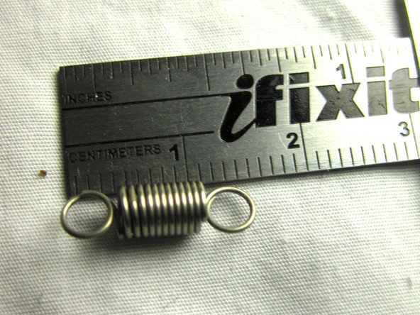

    2. Canon ImageCLASS MF4350d Transformer Replacement: crwdns2935265:06crwdnd2935265:01crwdnd2935265:02crwdne2935265:0 Canon ImageCLASS MF4350d Transformer Replacement: crwdns2935265:06crwdnd2935265:02crwdnd2935265:02crwdne2935265:0
      • Locate the spring.
      • Unhook the spring on the side of the metal box.

      • Unscrew the 10mm screw attaching the metal plate to the printer.
