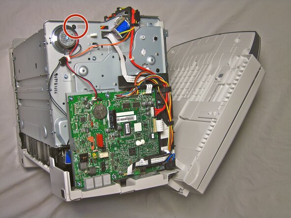

  5. Canon ImageCLASS MF4350d Speaker Replacement, Speaker: crwdns2935265:05crwdnd2935265:01crwdnd2935265:01crwdne2935265:0
    • Lay printer on its left side for better access to the speaker.
    • Note: The scanner lid needs to be supported when moving the printer

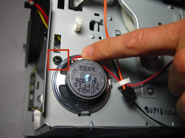

    • Locate the black 7mm screw holding the speaker in place.
    • Using a Phillips head screw driver, unscrew the 7mm screw.

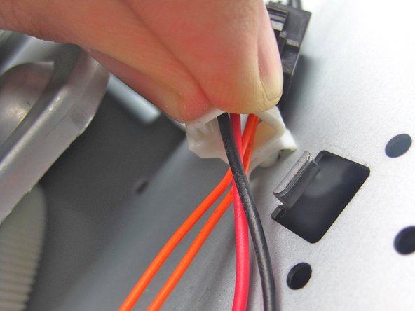

    • Locate the red and black wires connected to the speaker.
    • Undo the white clip holding the wires in place by pinching the tab on the top.
    • Remove the red and black wires from the wire bundle.

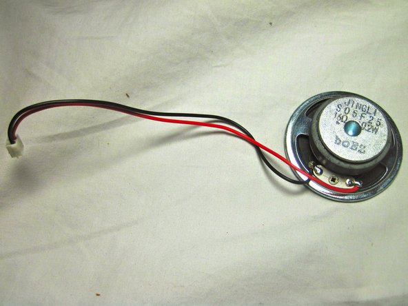

    • When replacing the old speaker, do not touch any part of the new speaker that is not metal other than the wires. Doing so could damage the speaker.
    • Lift out the speaker
