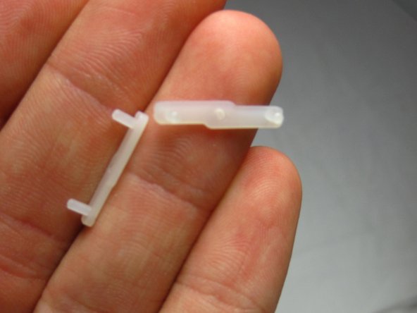

      • Two white tabs are located on the sides of the black component that houses the scanner light. Pull these tabs out, and set them aside.
      • Remove black component by gently pulling it up from the black scanner belt.

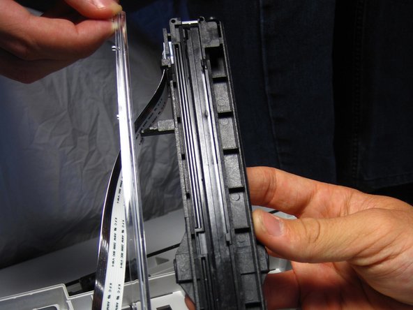

    2. Canon ImageCLASS MF4350d Scanner light Replacement: crwdns2935265:07crwdnd2935265:01crwdnd2935265:02crwdne2935265:0 Canon ImageCLASS MF4350d Scanner light Replacement: crwdns2935265:07crwdnd2935265:02crwdnd2935265:02crwdne2935265:0
      • When removing the light, you should be careful not to snap the plastic. If you do snap the plastic, handle with gloves and use extreme precaution, because the plastic may be sharp.
      • The light is in the middle of the black component. Remove the light by prying up one side with the plastic opening tool and working your way to the other side of the light.
      • You may hear a snapping sound as the light detaches from the component.
      • Once you have taken out the damaged light, replace it with a new light.
