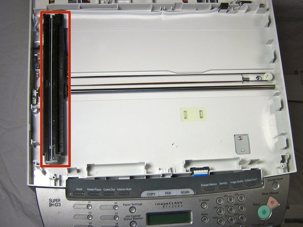

      • Next, locate and remove the four 10mm screws.
    4. Canon ImageCLASS MF4350d Scanner Belt Replacement: crwdns2935265:04crwdnd2935265:01crwdnd2935265:01crwdne2935265:0
      • Gently, pry off the top plate, starting from the back of the printer.
    5. Canon ImageCLASS MF4350d Scanner Belt Replacement: crwdns2935265:05crwdnd2935265:01crwdnd2935265:02crwdne2935265:0 Canon ImageCLASS MF4350d Scanner Belt Replacement: crwdns2935265:05crwdnd2935265:02crwdnd2935265:02crwdne2935265:0
      • After you have taken off the plate, check to make sure that there is no broken glass. If there is broken glass handle it with gloves. Broken glass, if handled improperly, can cause physical injury.

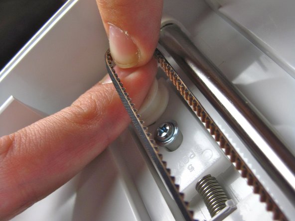

    1. Canon ImageCLASS MF4350d Scanner Belt Replacement, Scanner Belt: crwdns2935265:06crwdnd2935265:01crwdnd2935265:02crwdne2935265:0 Canon ImageCLASS MF4350d Scanner Belt Replacement, Scanner Belt: crwdns2935265:06crwdnd2935265:02crwdnd2935265:02crwdne2935265:0
      • Remove the black component by gently pulling it up from the black scanner belt
    2. Canon ImageCLASS MF4350d Scanner Belt Replacement: crwdns2935265:07crwdnd2935265:01crwdnd2935265:02crwdne2935265:0 Canon ImageCLASS MF4350d Scanner Belt Replacement: crwdns2935265:07crwdnd2935265:02crwdnd2935265:02crwdne2935265:0
      • Press down on the white release and force it in toward the spring as shown. While you do this, pull the scanner belt out of the track.
      • Take a new belt and put it in the same way that you took it out.
